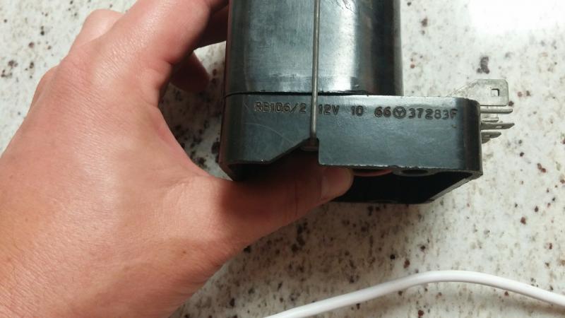

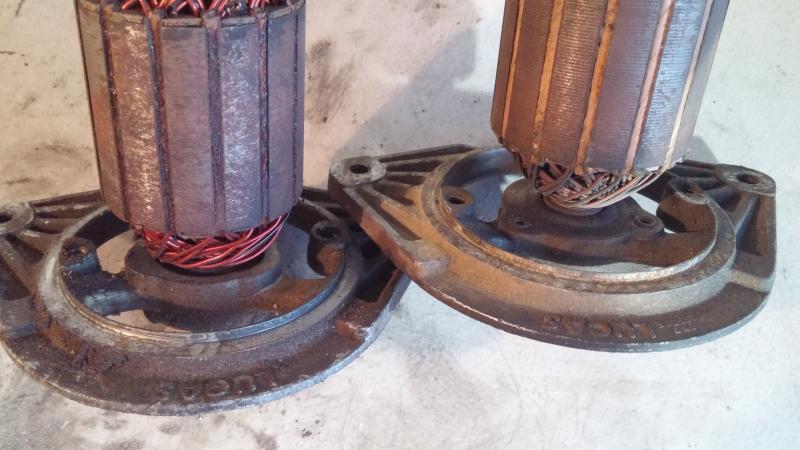

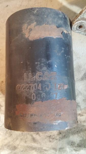

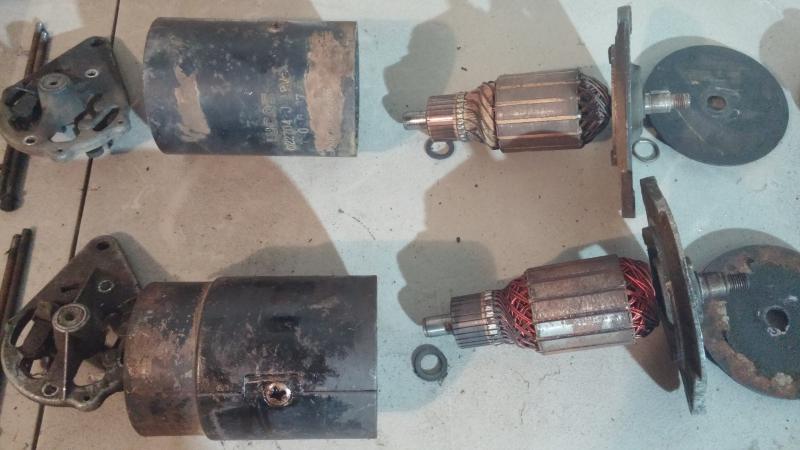

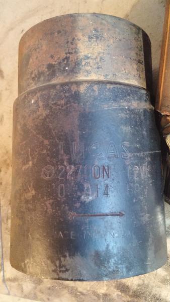

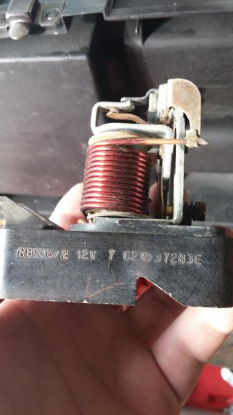

OK Guys. So cleaned them up a little and got some pics of the part numbers and the part numbers off the regulators. I also included a picture of the two different armatures.
Soooo...goes like this:
Generators:
Came off the car (non-step housing and right armature in picture attached): 227004 J 12V 040-6-67
Spare (stepped housing and left armature in picture attached): 22700 N 12V 010-14-69 (9 is hard to distinguish)
Regulators:
Came off the car: RB106/2 12V 7 62-37283E
Spare: RB106/2 12V 10 66-37283F
The two armatures are different at the end plates where the bushing is put in. One is secured with a plate and rivets and the other that goes in the stepped housing looks like it is just pressed in. So I'm not too sure if these are interchangeable. If this is going to be too much of a PITA I'll just go the alternator route. I want to keep as much originality on the car as possible and I'm not going concours, but I'm going Toyota 5spd at some point and I will probably go aluminum radiator since the lower part of my original is bent beyond repair. Unless someone has an original end tank for the bottom!

So looking at TR3driver's equipment specs post it seems that the regulator I had on it is the correct one. Maybe the "F" one supercedes it. If there is a way to test these I will do that. I'll make sure the original is in working order and then just use the new cover from the "F" one on the "E" one. Now the generator...that's a different situation.
