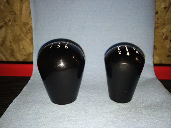

Even though I'm doing a fair amount of modifications to my Bugeye (5-speed, 1275, front discs) I'm doing everything I can to keep the appearance stock. One item I wanted to find was a shift knob that had the correct 5-speed pattern but looked reasonably stock -- I'm not a fan of wood or leather shift knobs. A bit of Googling brought me to these fellows:
Futofab:
https://www.futofab.com/index.php?option=com_content&view=article&id=90&Itemid=94
So I ordered one up, black with white writing, dogleg pattern, M8x1.25. Came in today and I compared it to a stock one. The Futofab knob is a bit larger than stock, but the shape is similar. I like it. Should make for a stealthy look.
Now I just need to restore the rest of the car. Guess you have to start somewhere. :grin:

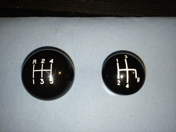

Would you please post a pic of the underside of the knobs side by side? I'm curious.
Futofab 5-speed knob on left, stock knob on right. My stock knob has a metal insert from bugeyeguy.com, never was a fan of the feel of the original rubber insert these used.
