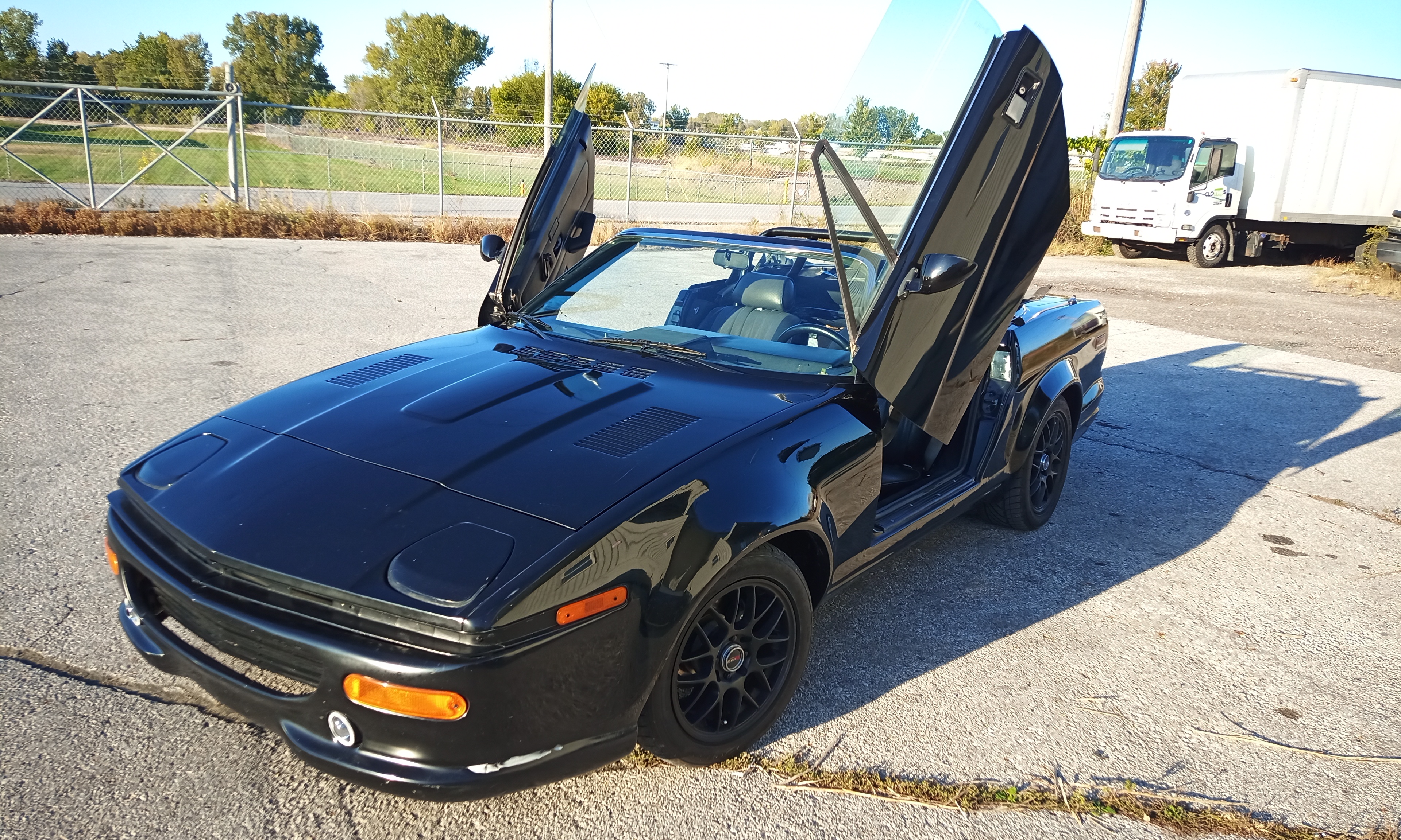

Wedge 1981 TR8 (300hp) need ideas Pros/Cons to upgrade my rear end differential. Do i go Quaife or Ford 8/9inch? or other alternatives
TR8ToddSomers

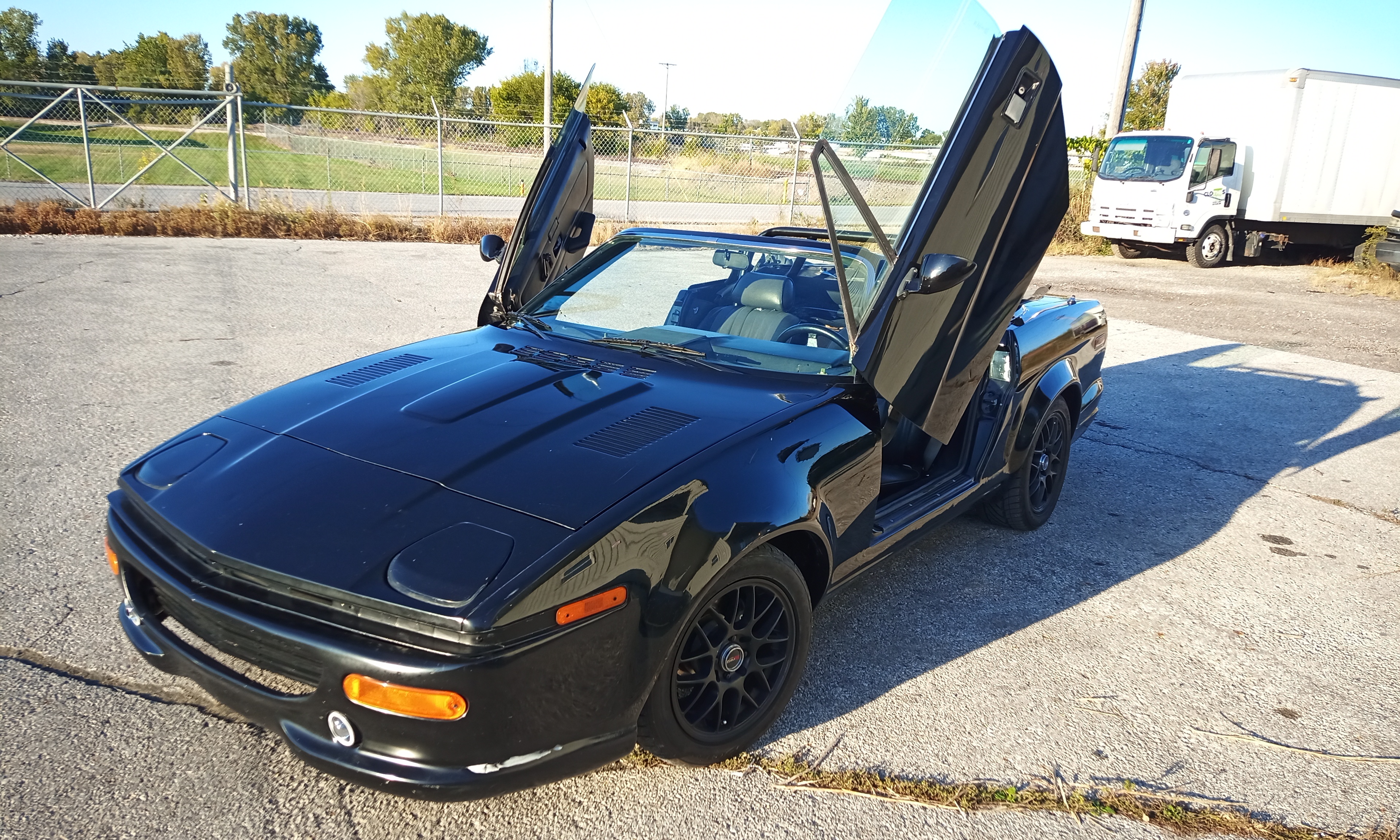

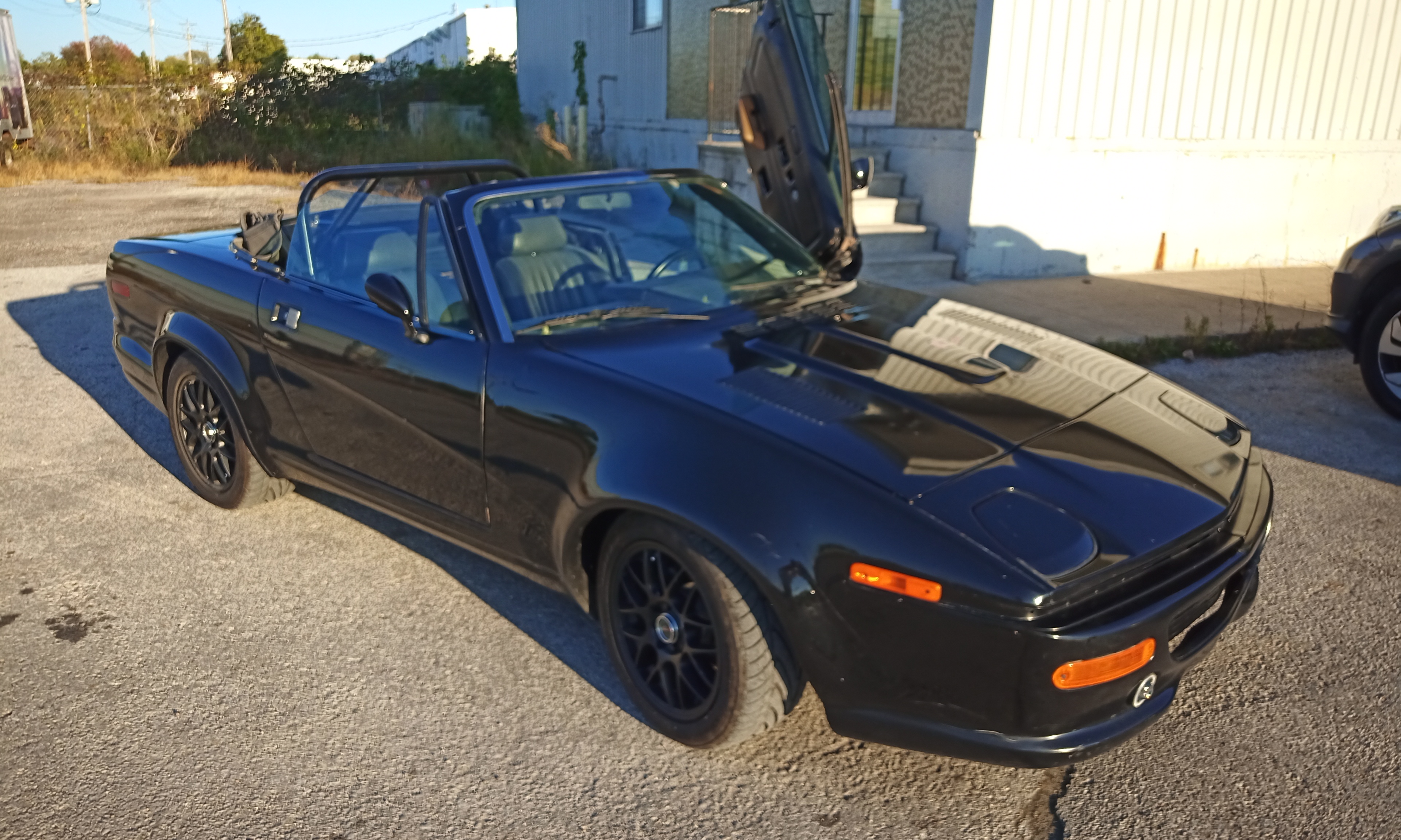

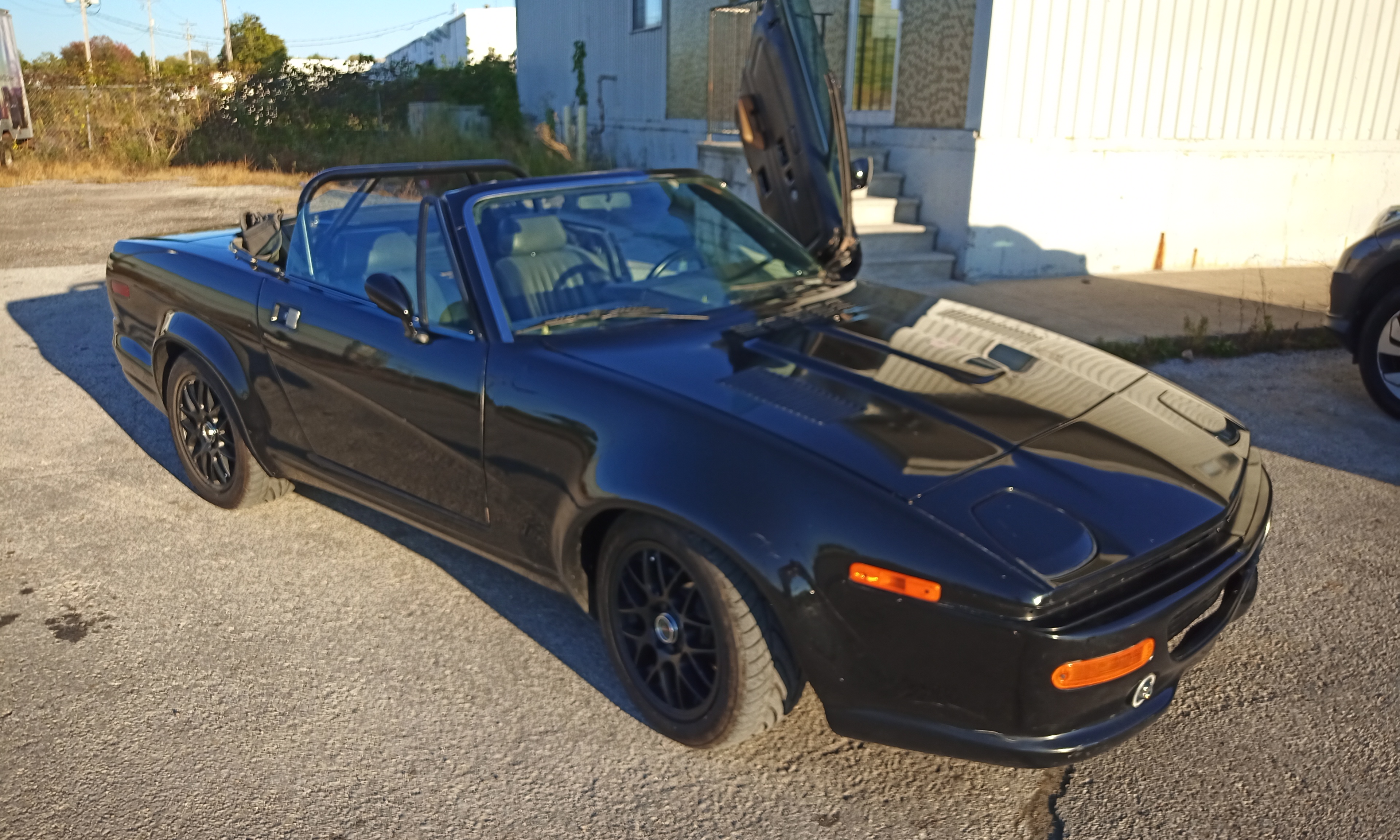

I have a 1981 Highly modified Triumph TR8, Stroked out original engine to 300hp. I have upgraded front suspension, and brakes. Swapped out my Transmission for a Toyota supra W57. 15 in. Wheels Vertical doors. Body kit. But now i need finish the drive train with LSD, posi, Quaife Diff with better gearing... OR ...i was told a whole ford 8" rear end or with axle that comes with brake rotors...Anyone with Pros and cons and or with used parts...Im in Iowa USA... please call 515 718.5681 or email tsomers at protonmail ...I dont want a monster...just a reliable and mean rear end to max out the ability of these beautiful cars. See my pic View attachment 106972

Cool car, Todd.
IMHO: The Ford 9-inch is kind of the standard, traditional, rear end for high power hot rods. But a lot of people use the Ford 8.8 because it's more available and can be had with limited slip and disk brakes. It can easily handle 300 hP. One out of a first gen Explorer (a little over an inch wider than the stock TR8) might fit pretty close overall. It would also have options for gearing. That's probably what I would do.
But it's not what I did. Consider that a first generation Miata independent rear suspension and differential would fit perfectly (1/4 inch narrower than the stock TR8) and probably handle the power just fine. They are available with limited slip. It would be a lot of work swapping in the rear subframe for the solid axle and leaf srpings. But obviously you are not afraid of change.

Ok All great suggestions ... Let me limit my question...First NOT a limited budget and i dont want to reinvent the wheel. Its like when i give it the beans ...im not thrown back in my seat... Performance wise ... adding a Quaife dif would give me a score of what? 30% bump? Vs 8.8 Ford? Would the performance bump be more or less that the Quaife. Yes I know it will cost more to modify the whole rear axle.... BUT i would get disc brakes AND i heard you can change the gearing on the Ford for quick of the line vs High end speed. And when you ask what do i use it for... i wanna be able to use it as a daily ...and maybe hit a few auto crosses... but just like to pull up next to a Porsche and watch his mouth drop. llol So i guess you call that Stage 2... Thanks for all your advice guys....
