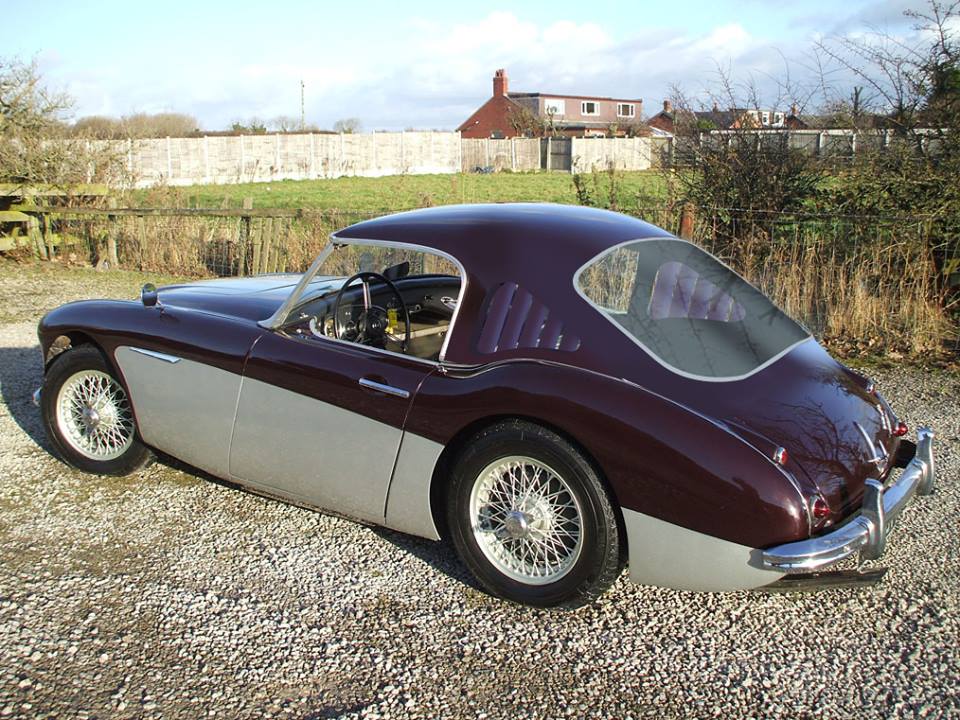

The back window is too big its out of proportion .Makes it look like a hatchback Volvo .
I'm afraid it's not doing it for me either. The top part looks rather bulbous and the rear rather large as Healey Nut suggests. You might try changing the louvered portion to clear glass to break up the expanse of color a bit. I like the CapeSport rendering better, but I don't think one has ever been built and perhaps that roofline isn't practical in real life:
