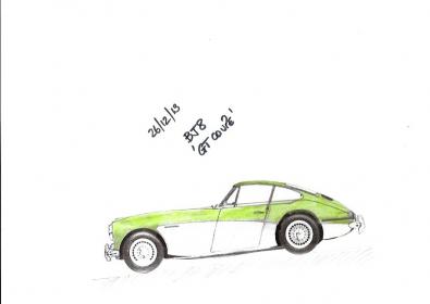

1967 BJ8 Coupe based upon the ACME advert
Derek I plan to keep the original boot lid in design and size only.. I will use the original hinges, method of opening, etc. The lines of the boot will be incorporated in the overall flow of the coupe shape. In reality it will be flatter than the original. At this point we are looking to keep the existing rear light configuration and form so that from the rear its distinctly a Healey...
I like that the chrome door top finishers have been removed. Never really liked the look of them and know why they are there on the convertible but are not needed for a coupe.
Love it. I liked the look of the GT6 top on the AH, but the drawings you have look great and make the GT6 car too tall/ bulbous and clunky.
... At this point we are looking to keep the existing rear light configuration and form so that from the rear its distinctly a
Healey...
Good plan, keep the rear lights and part of the rear schroud. Side exit for the fuel and a nice long backwindow
From a engineering standpoint, I would add a roll bar that would flow with the rear roof lines, it would add rigidity to the roof section and attachment points, starting from behind the seats sloping to the rear. This way you can also have a removable roof panel from the beginning of the roll bar cross brace up to the windshield frame. Good luck, Drambuie.

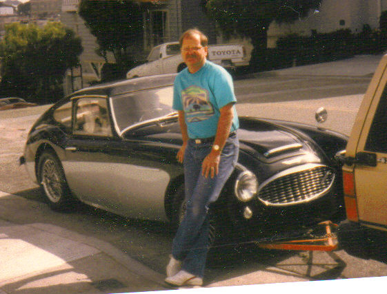

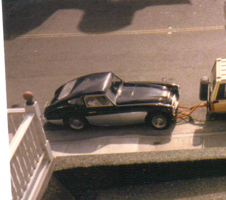

Healey top 1.jpgHealey top.jpg This is a fiberglass removable top that came from the UK that fitted my 60 BN7. It came with the Healey I bought in 1988. I lost the top in a strong gale that shattered it. It was connected in the front along the top of the windscreen with eye-bolt clamps. The car boot lid came off and was attached to the rear opening of the shell. There were internal center post rods that fit into the holes for the soft top. Internal structure was braced between center posts with a solid molded piece. The rear was held in place with the boot latch. I just wish I had kept the damaged shell. It could have been repaired. There were molded openings for the rear lights. The fuel cap was accessible via the interior area under the rear window. All windows were plexiglass.
In the drawing you have removed not only the chrome strip below the window but also the metal underneath it. I don't know anything about BJ8s but can you do that and retain the wind up windows?
This coupe will not be a convertible with a hard top add on but re-engineered with a welded roof structure in one piece that incorporates a new rear shroud in sheet metal (replacing the existing one in alu). This will obviously increase the overall weight (and affect the performance) but ensures the chassis rigidity and will allow us to achieve the flow from the roof down to bumpers without creating an 'egg shape' when viewed from the back end. The chrome door/window strips will be retained and the new rear quarter light windows and rear window (with chrome surround) will be sourced.

View attachment 30777View attachment 30778 This is a fiberglass removable top that came from the UK that fitted my 60 BN7. It came with the Healey I bought in 1988. I lost the top in a strong gale that shattered it. It was connected in the front along the top of the windscreen with eye-bolt clamps. The car boot lid came off and was attached to the rear opening of the shell. There were internal center post rods that fit into the holes for the soft top. Internal structure was braced between center posts with a solid molded piece. The rear was held in place with the boot latch. I just wish I had kept the damaged shell. It could have been repaired. There were molded openings for the rear lights. The fuel cap was accessible via the interior area under the rear window. All windows were plexiglass.
Really neat pictures and top, Mert. Thanks for the input.

Looks like a great project. One thing I'd do is bend some steel rod in the shape of your design and put it on an existing car (lots of protective tape). Put it over the driver seat and sit in the car. That will tell you if you need to make adjustments before too much work is done.
Personally, I think the roof will wind up looking thicker when viewed from the side than the latest design. I believe some sort of compound curve will have to be added to the roof to keep it from oil canning and also give it some strength.

Some have suggested that my drawings resemble the back end of a porsche... I have asked an artist to create some scale drawings to show that despite the resemblance to a porsche back end the finished article with have a more rounded rear end with all the distinctive Healey qualities..
