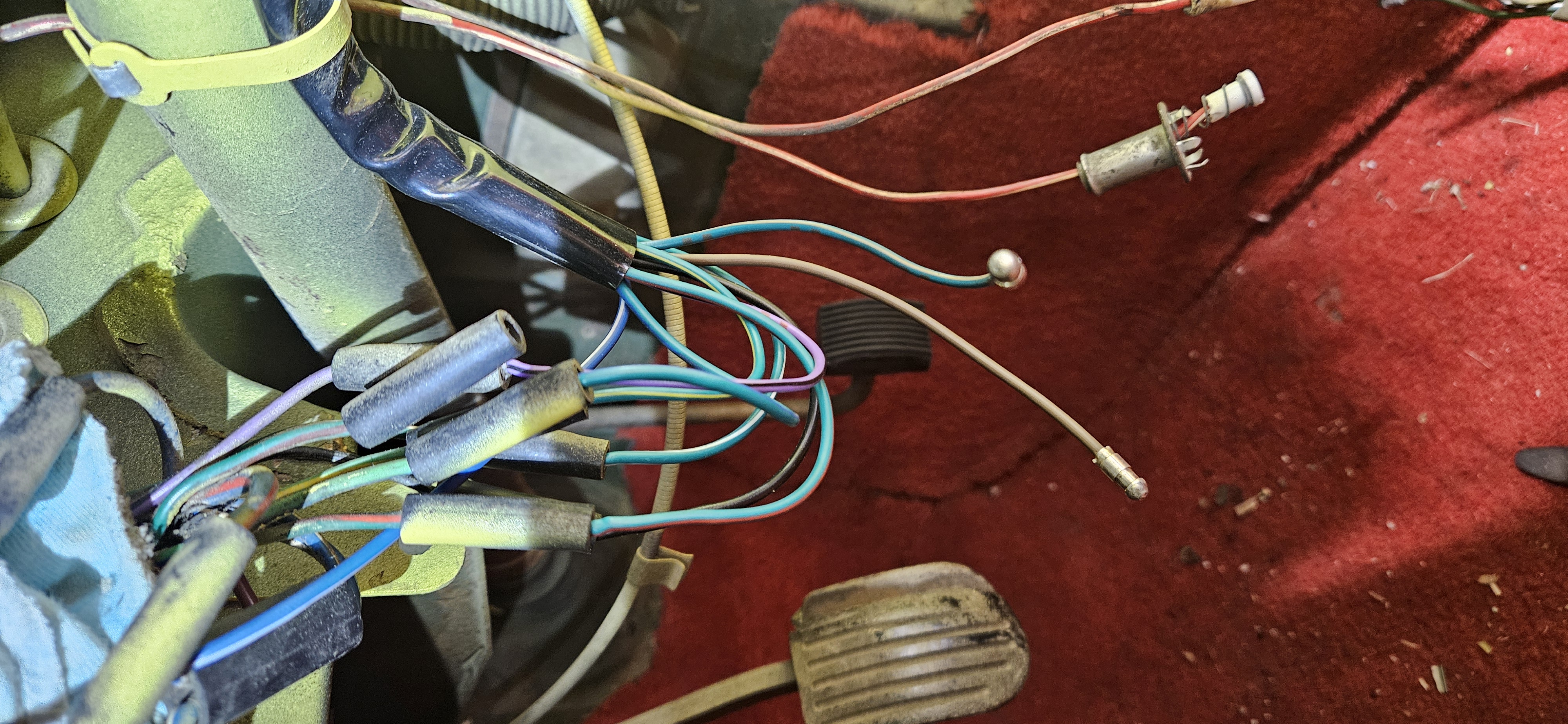

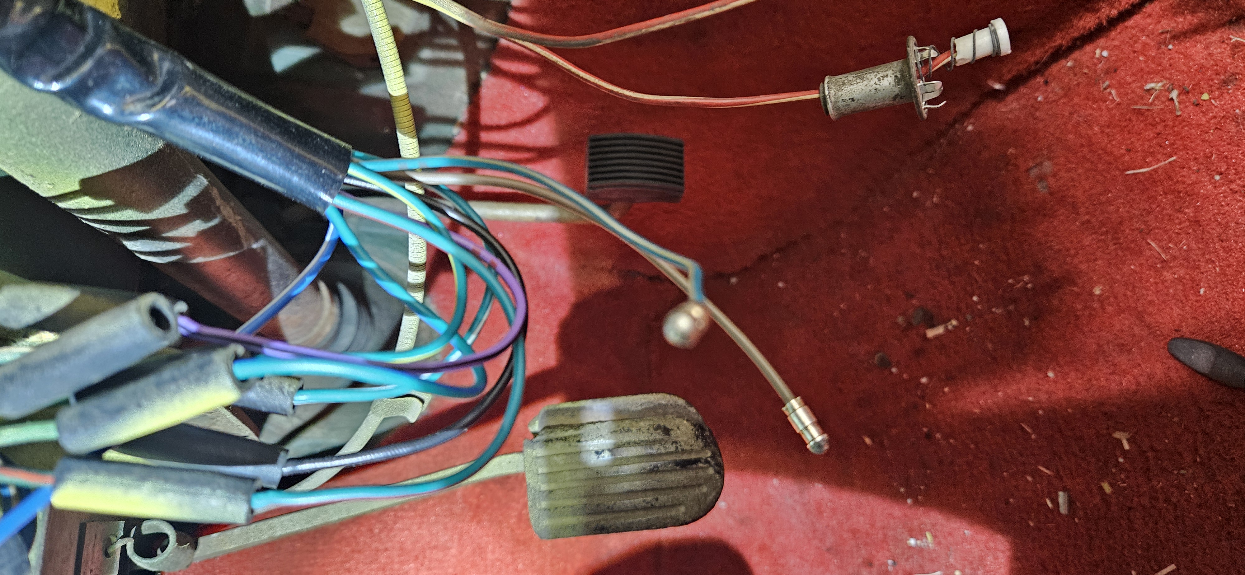

I can try and take pictures of the Wiring and the Relay as well as how the connectors are on the Column Shifter for the Lights. There is one Brown wire left not connected from the Column but I couldnt find where that should go. Maybe that is another issue?

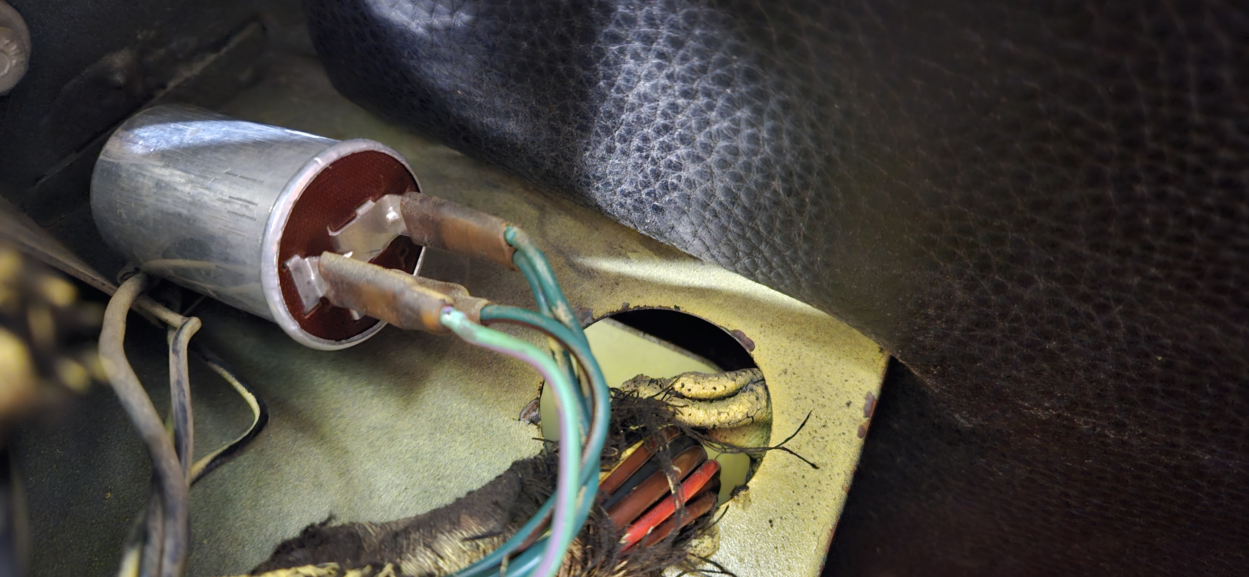

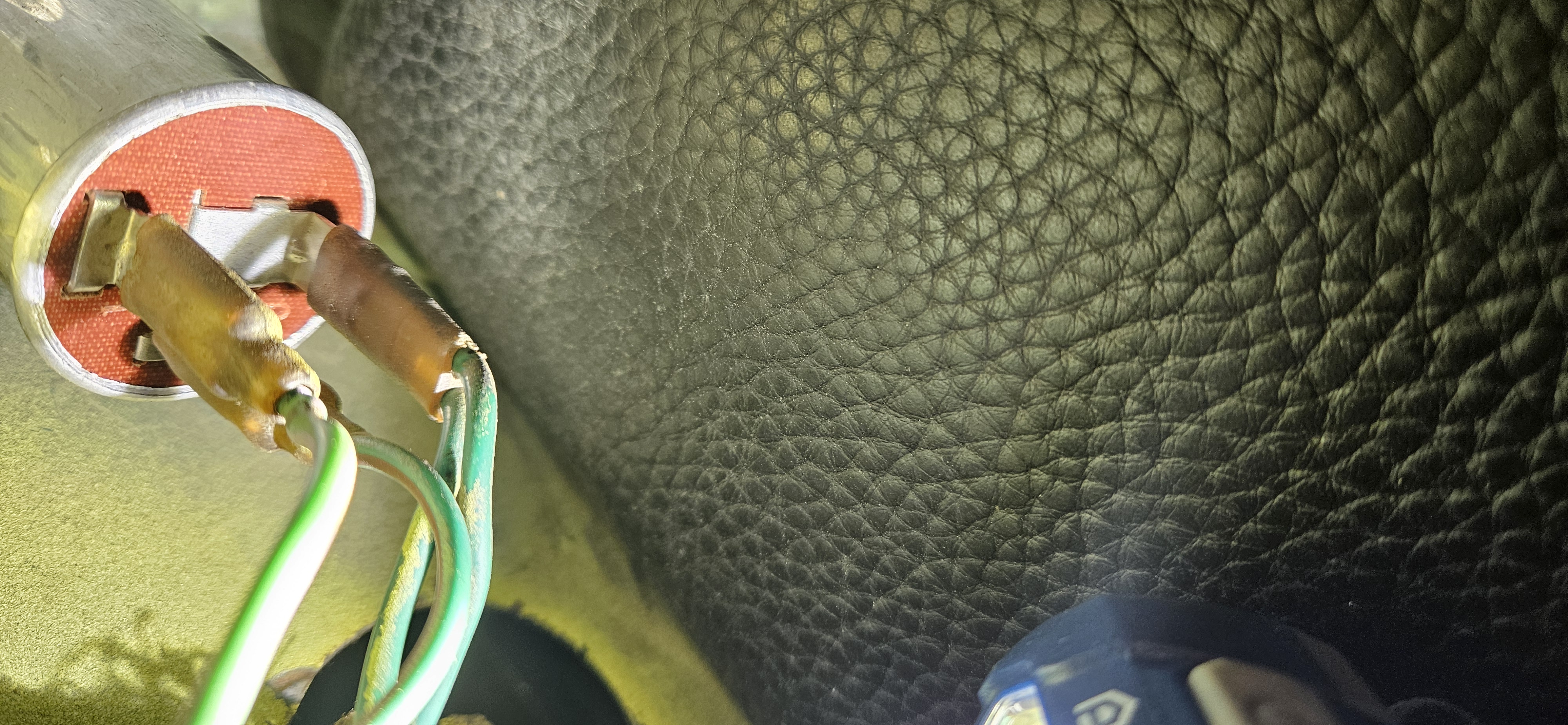

I am at a loss still. Hopefully these pictures can help someone answer this for me. So here is my run down. I have directly put battery power from Positive to all 4 Lights each. In fact, when I do a wire on the Left side front, it also turns on the back. So that tells me 2 things, One the wires are good front to back, and the Grounding is good. So then I went under the dash, ran a wire directly from the Positive side of the battery and put it inside the Green/Red Stripe wire and the lights came on. So that tells me also that power is going through those wires with no issues. I then used a Volt meter and turned on the ignition and got 12 volt then I put the Double Solid Green back into the "X" terminal since apparently the new one has X and not B (Unless this is the wrong type flasher from Moss Motors). then I put the Tester on the "L" and received 12 Volt. The Unmarked "on the wire schematics and on the flasher) and received no power. Not sure if this is on purpose or I missing something. Got these results on a new Flasher and the Original that I thought was bad. Here is my results. I NOW have the Left Indicator Light show up on the dash but stays solid. Switching to right has no light (but I dont know if the indicator on the right of the dash is out yet) BUT neither Left nor right Lights up on the car.... Hopefully with all of this information and the pictures, maybe someone can tell me what I am missing or what I can check next. This car is practically ready to go and this is the only thing keeping it from Drive Worthy on the road and I am ready to get out and drive this thing everywhere. THank you all in advance.

Also, I do see this in the link someone provided above, But could someone walk me through the best way to test this and how? Like which two wires do I combine to test from the flasher? Where should I test voltage from the indicator switch to the Flasher?
->If you suspect the flasher unit itself just bridge its two contacts. The lights should light, but not flash.<- Which 2 wires?
I'm looking at the wiring diagram for the earlier cars right now, and yes I can see how this gets confusing. It looks like the instrument panel indicator lights are in fact a separate circuit from the actual front and rear lamps. The later flashers only had 2 contacts, which is why the tip of briding the 2 contacts doesn't make sense in your case.
Based on the wiring diagram, the connector with the 2 green wires is your incoming power from the key-on fuse - you should have +12 there at any point when the key is on.
The green wire with the brown stripe is the one that goes through your turn indicator switch then onto the front/rear lamps. The green wire with the purple stripe is is related to the instrument panel indicators (my guess is it feeds the pulsing 12 volts out on that wire through a set of secondary contacts at the turn signal switch and then to the selected panel indicator light).
If you disconnect the double green wire and the green with brown stripe wire, then connect those together that would be the 2 contacts that should allow the left or right front/rear lamps to come on (but not blink) when you make the selection at the switch. The panel indicators won't come on in that configuration from what I can tell. Again this is all just from studying the diagram - my car is much later and has a completely different system.
