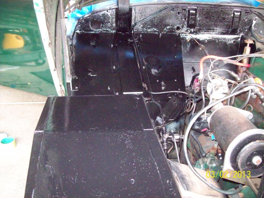

I will post some update pictures next week. I should have the harness done, lights in and have a pretty good start on the interior. All of my interior should be here Monday, except for my carpet set. Which is backordered. I actually welded in my new floors weekend before last. Just haven't had a chance to do much since. Though I did start the harness last night.

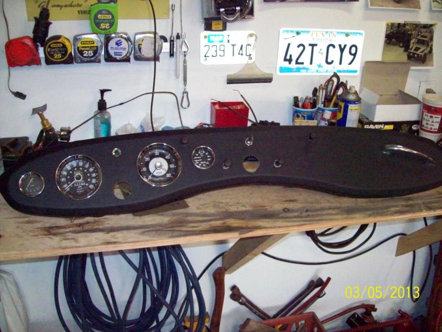

Just a suggestion, I pulled the dash, had it recovered, cleaned up the gauges and the windshield wiper tubes and cable, fixed the windshield washer jets at the same time it was all out. I wired everything that I could on the bench, even reinstalled my gauges before putting the dash back in. It is doable without pulling the dash, but a PITA.
Even with an expensive harness from British wiring there were still a lot of missing terminal ends I had to put on myself, missing ground wires (by all means add redundant grounds, especially to things like gauge cases, which were supposed to be grounded through contact to the dash). It is so much easier to do this on the bench than it is on your back.

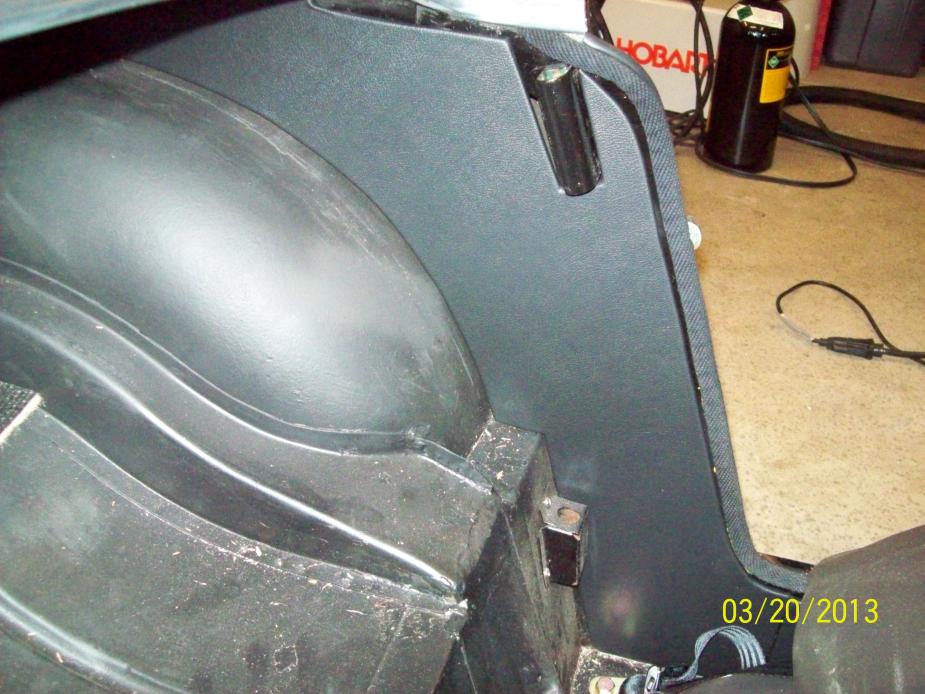

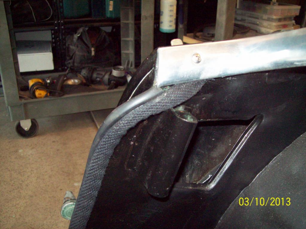

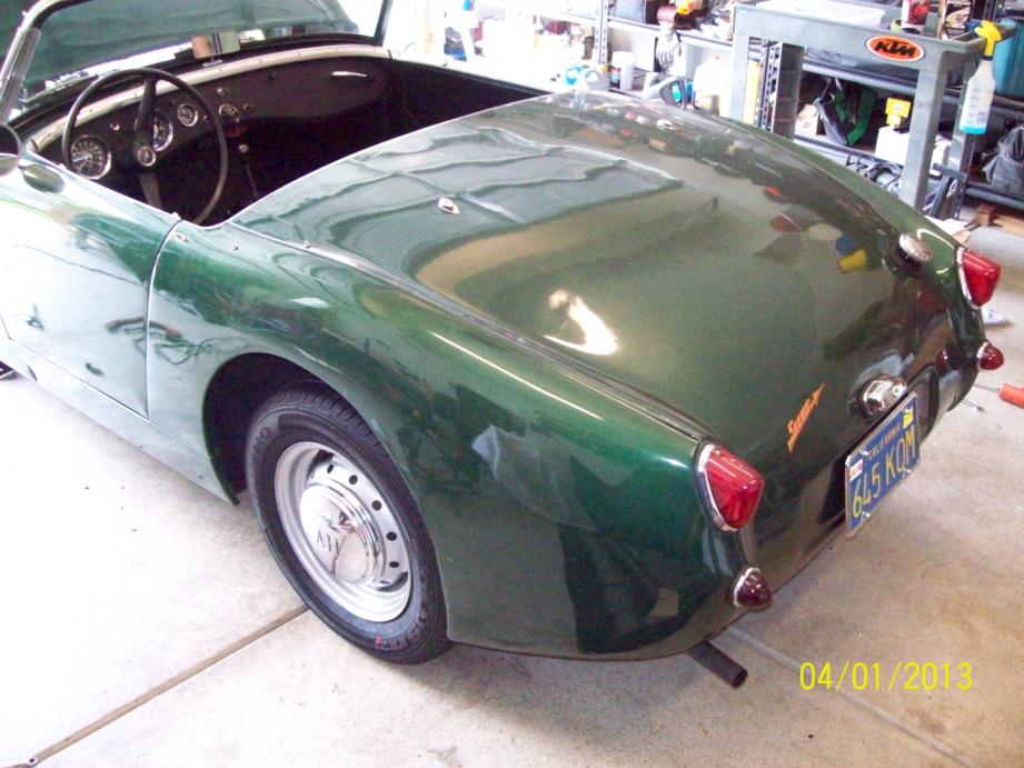

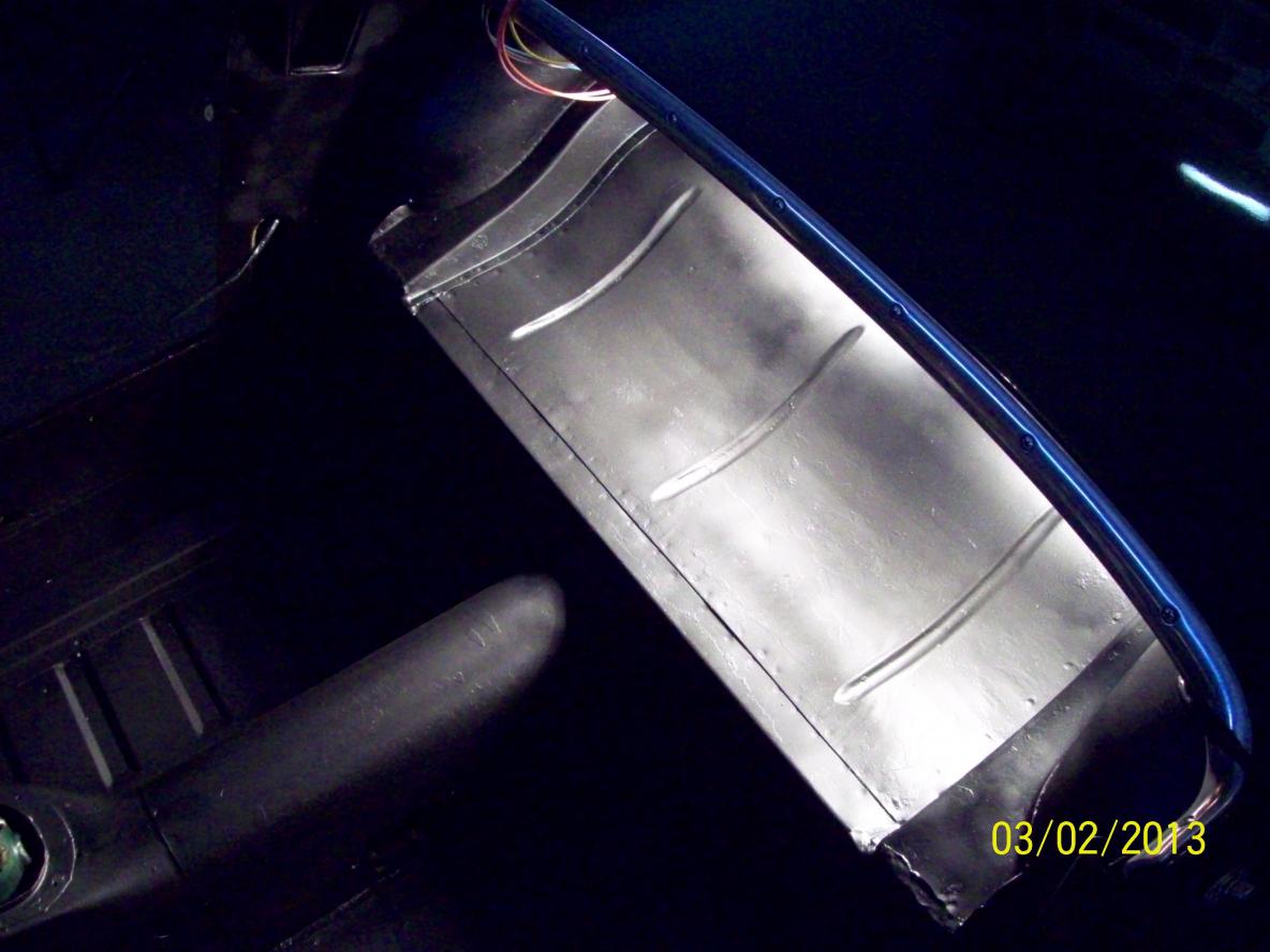

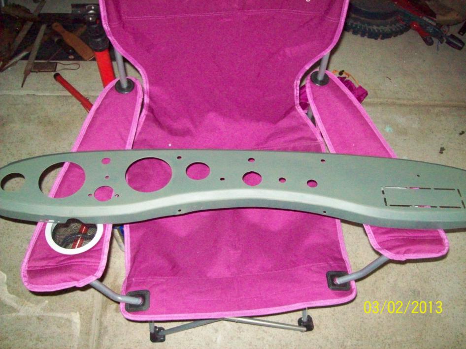

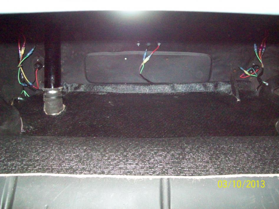

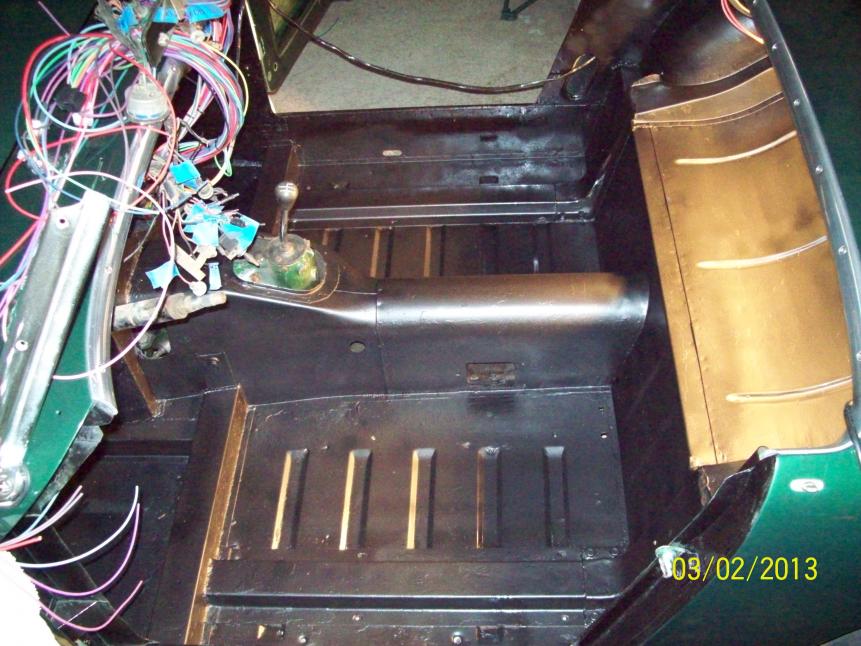

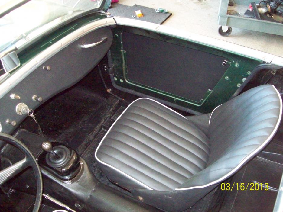

Update. Floor replaced, wiring in, new lights in. Interior panels made and prepped for vinyl. Hopefully I will get those done this week. Carpet should be in this week or next. Which should finish off the interior. Still have the brakes/wheel bearing to go through, get the rims painted and new tires. Then I think it might be time for a few days off working on it. 100_4590.jpg100_4592.jpg100_4601.jpg100_4608.jpg100_4637.jpg100_4645.jpg

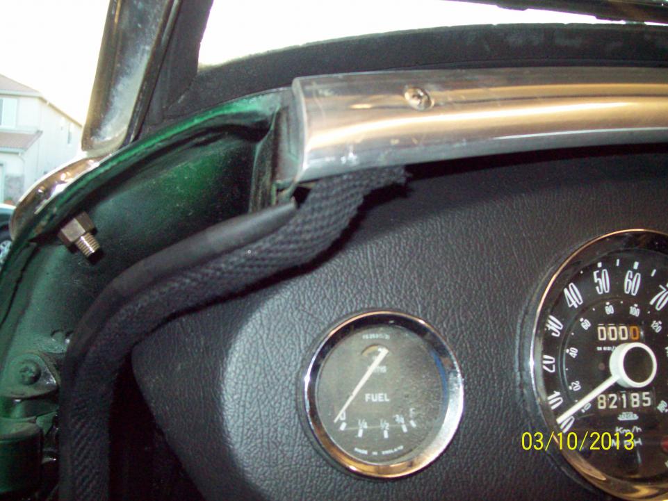

Nas90tdi: Just thought I'd let you know that your speedo is not original to the car. The speedo should look like the tach. Also the tach is mechanical drive off the back of the generator which makes changing the generator to a alternator a little more complicated. Looks like a nice car very well bought. Have fun!!

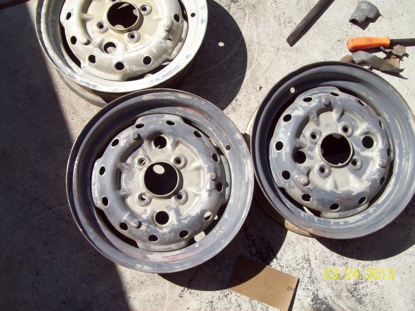

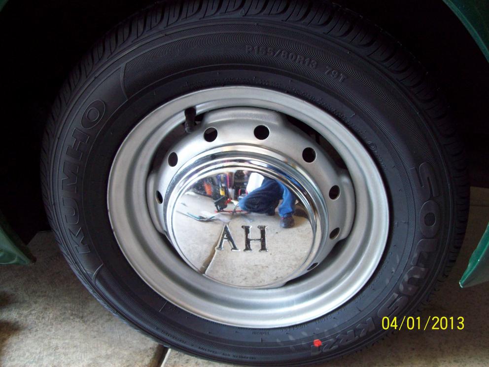

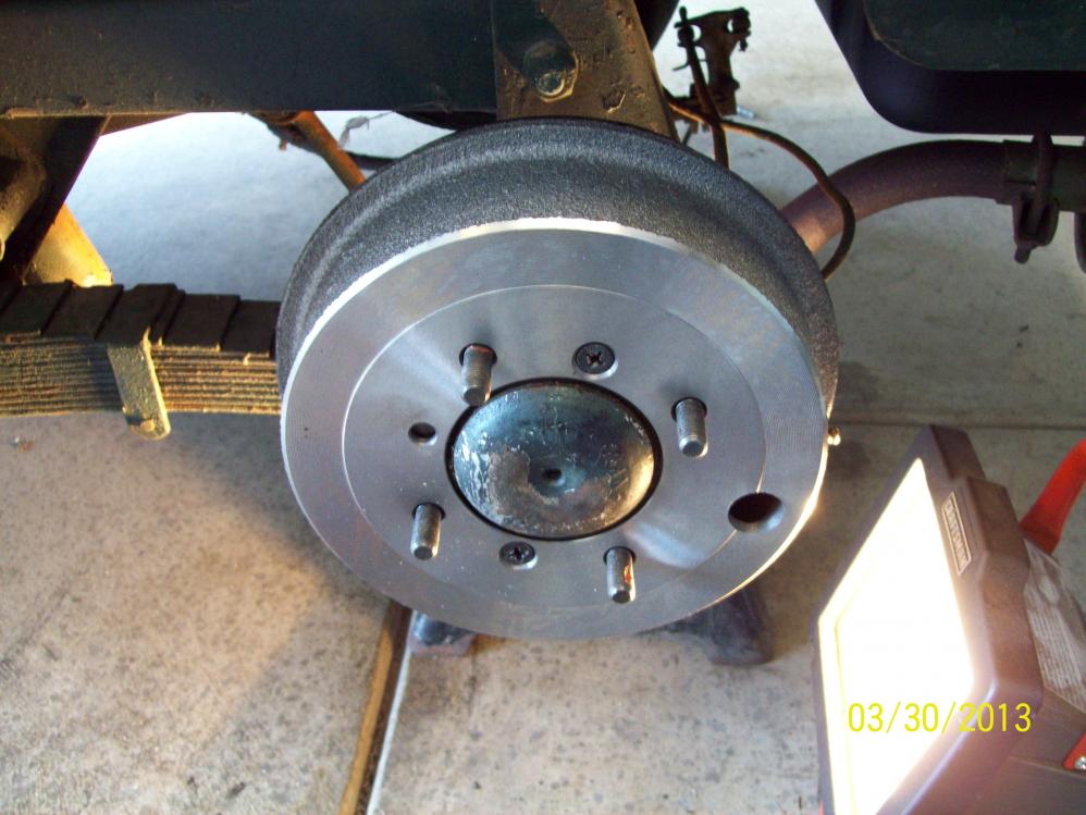

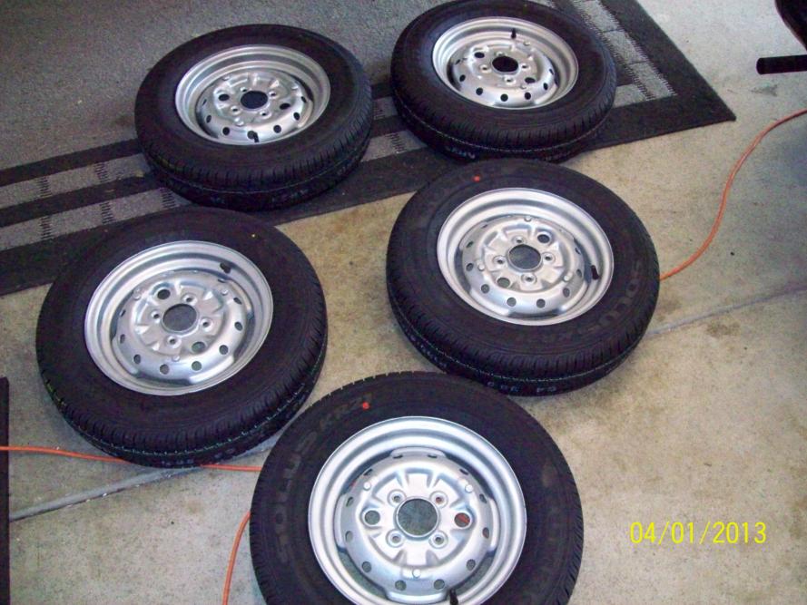

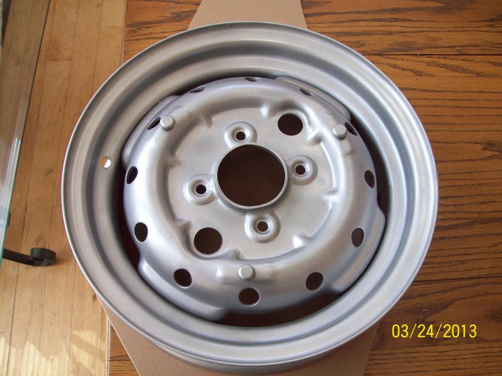

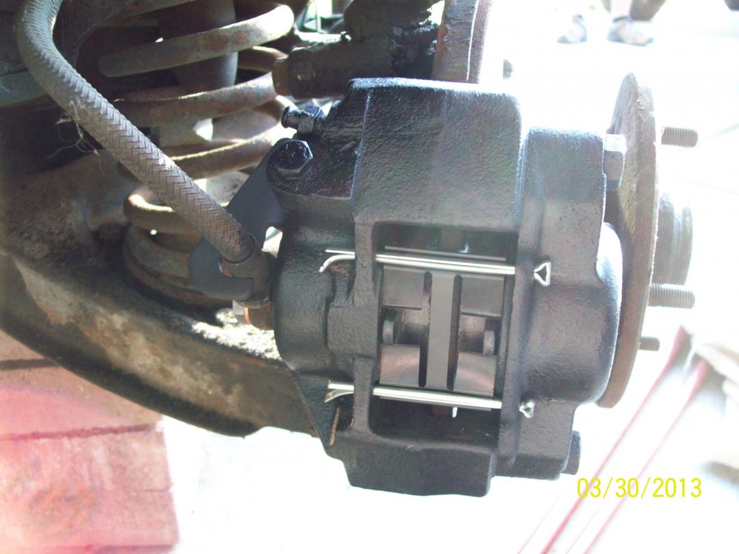

Got my wheels cleaned up and refinished. 5 new tires. Brakes all rebuilt and working. Right up till the point where the added pressure of blew out the master cylinder. I guess it needed the leaking wheel cylinder to let off the excess pressure. This is a good excuse to clean up and repaint the pedal box.

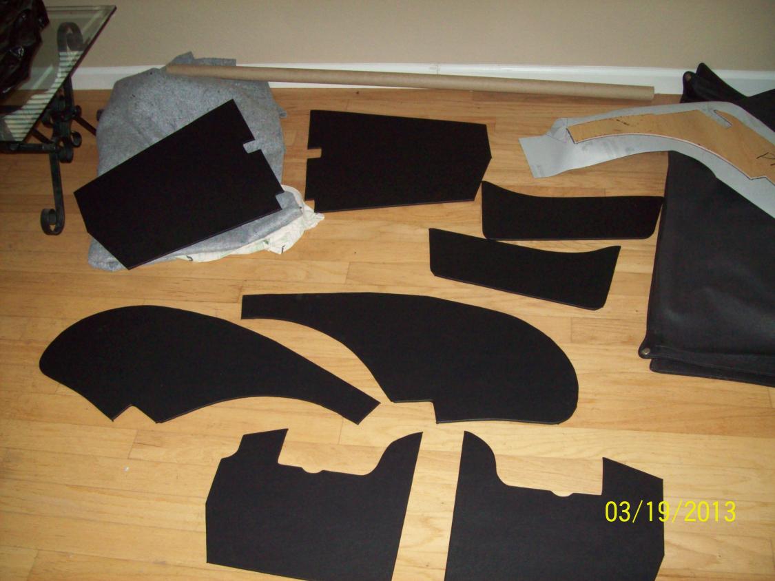

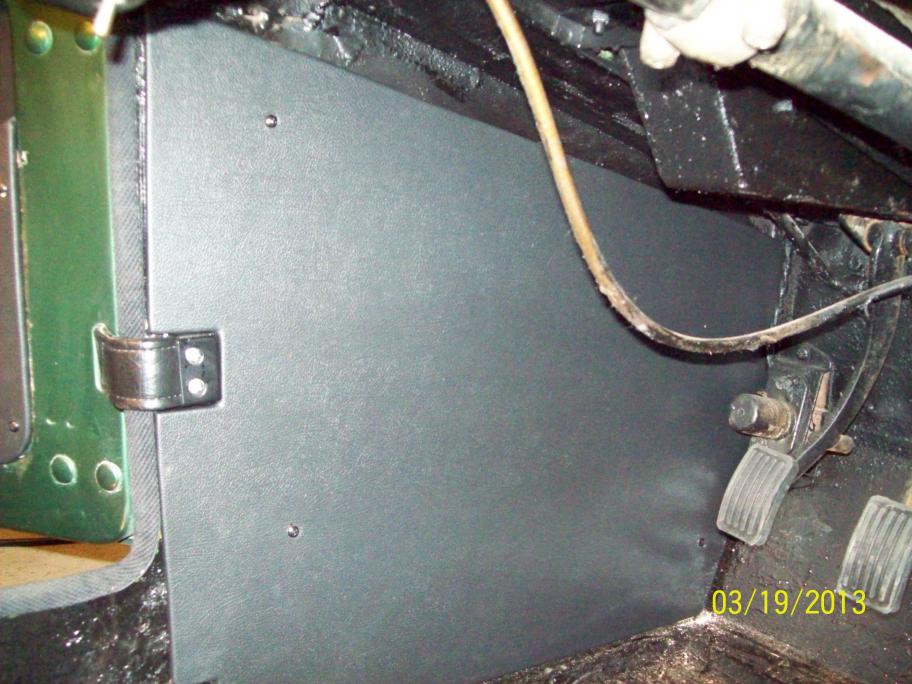

Interior panels made and installed. Carpet should be here tomorrow. Of course I can't put that in yet till I get the master cylinder rebuilt. But things are getting close to it being back on the road after 10 years.
Kurt

Are you rebuilding the original 7/8' MC? Since you have discs, you should have a 3/4" one.
https://gerardsgarage.com/Garage/Tech/DbrakeUg.htm
Gerard, Yes. As of now I am rebuilding the 7/8" MC. I agree with you on the 3/4" MC. But for the time being I am going to do the old one till I decide what direction I am ultimately going to go with the car. I am thinking it might not be with me long. I am just not loving the car in general and I have to in order to stay focused on a project. So instead of stalling out and leaving a great car floundering in my garage, I am just trying to get it back roadworthy so some one else might can enjoy it. And maybe take it to it's full potential someday. I hate to see old cars just sit and rot because someone lost motivation. I am as guilty of that as anyone, but I have learned to get rid of them before they sit around for 10 years.
And thanks for the advice. I view it as sound reasoning on the MC's.

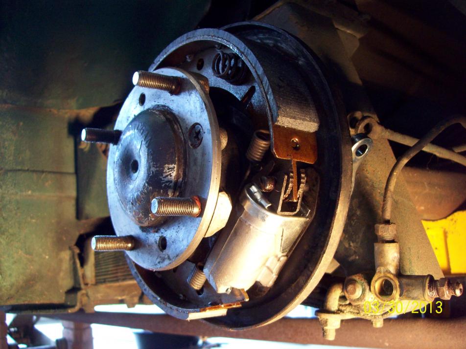

Sucks about the carpet, may be Jack Laird can comment on what he used in his car. Also I noticed that the springs on your rear drums are mounted on the front of the shoes. They should be at the back. I think they might hit the hub if not turned around.
Paul
