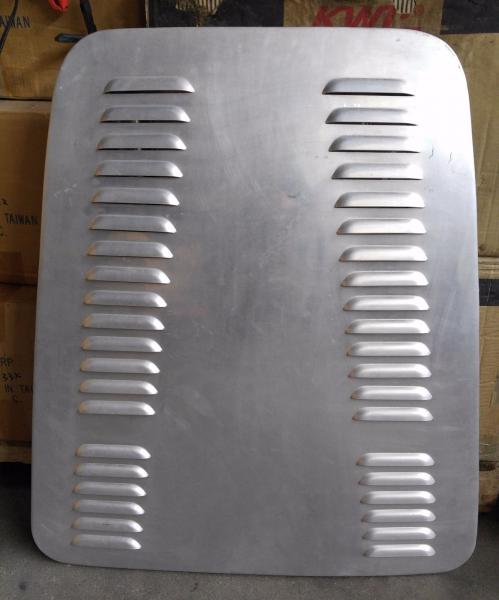

First real part purchased! I wasn't planning on buying this yet, but I found it for $850.00 on eBay, which saved me $250.00 over the Moss Motors price.
Also, Martin is starting on the Jule frame this week! Exciting times!
