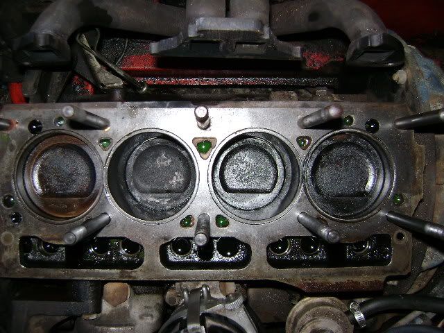

<span style="font-weight: bold">Duncan</span>--I would do as you have it listed. If the bores look OK, you can clean them up with a "dingleberry" hone (clean bores well afterwards and make sure any stuff on the crank is cleaned off too).
To be entirely honest, if the cylinder bores are decent, you could probably even skip the honing. Just before re-installing the pistons, clean the bores up nicely with a Scotch-Brite pad and some kerosene, wipe them clean and oil them with motor oil.
If there is a noticable "ridge" at the top of the bore, you may have to remove it. It may be just carbon (so you can scrape it off with a razor blade). If the ridge is due to excess cylinder wear, you'll have to decide if you need to re-bore the engine (big job). If the ridge is not too bad (say about 0.003"), you can use a "ridge reamer" tool to remove it (you may be able to rent/borrow one locally).

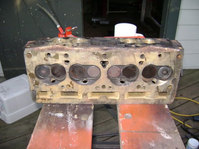

- got the head back from the machine shop, -0.100"

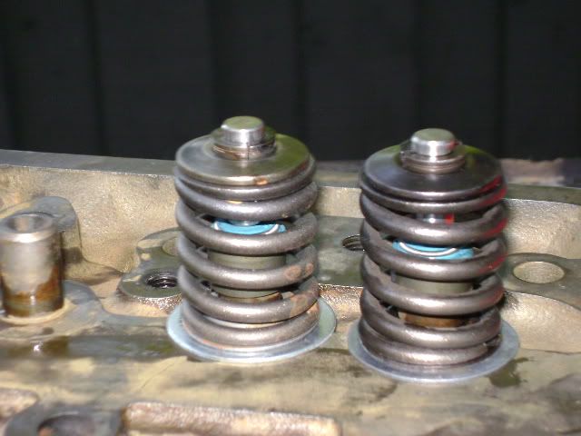

- Found the viton valve stem seals that have been banging around in my change jar for a year
- Turned on the bench grinder, and used a brass brush to clean up the valve faces
- Finished smoothing the intake runners, and thoroughly washed out all the passages in the head.

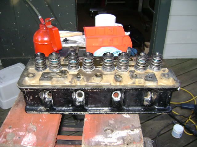

Excellent fit, nice-looking product... Of course, I fitted them all, and the realized that I'd have to put the shim and lower spring seat on first... :P
Broke down and bought a nice little spring compressor, which made this all very easy.

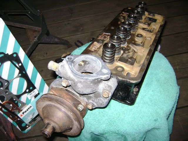

Hit my first snag, tho. The water pump housing casting (grey in picture) has been sitting in rust-disolving solution (phosphoric acid) for a couple of days. Worked great... except that the p/side (left in photo) threaded hole for the thermostat housing has lost so much metal, it won't bite. So I'm going to have to drill and tap it to the next size up.

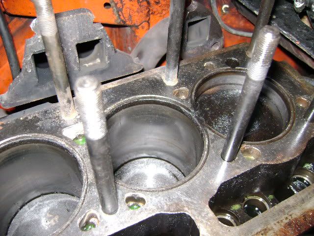

And just to round it off... a couple of pictures of the bores.

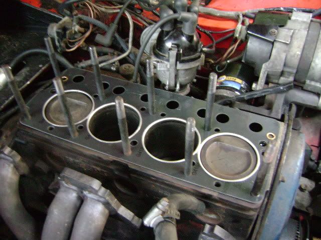

Well, after boring the waterpump housing bolt hole oversize, managed to get the head back together. Cleaned up the pistons a little more, and started to put everything back together.

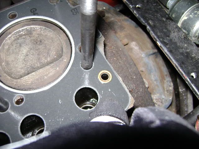

The Payen HG is MUCH nicer than the generic sandwich gasket that came out. the rings that fit into the grooves around each cylinder are much more solid, and there are nice little crush rings around the water passages. I decided to put it on dry, per the manufacturer's recommendation.
Got the head torqued down, although not without a little drama. Got to bolt #10, and I got to 30 lbs, 40... and it went loose. AAAGH! Stripped it. Undid the nut, and realized the head bolt was intact, and only the inner thread in the nut had sheared. Found another nut, and it torqued down fine. 46 lb/ft of torque for the head bolts, 32 lb/ft for the rocker-to-head.
