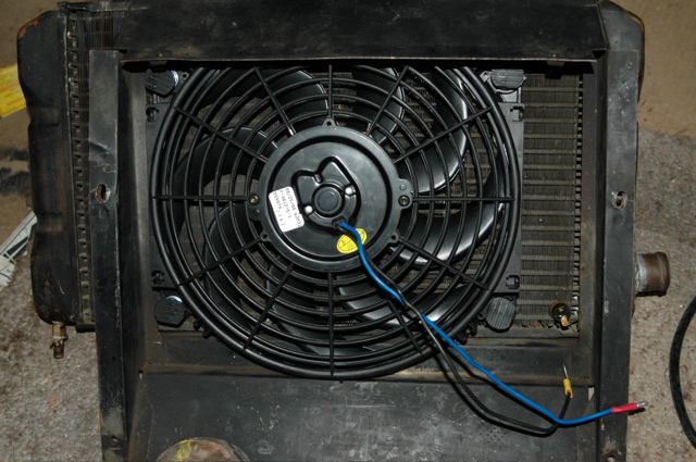

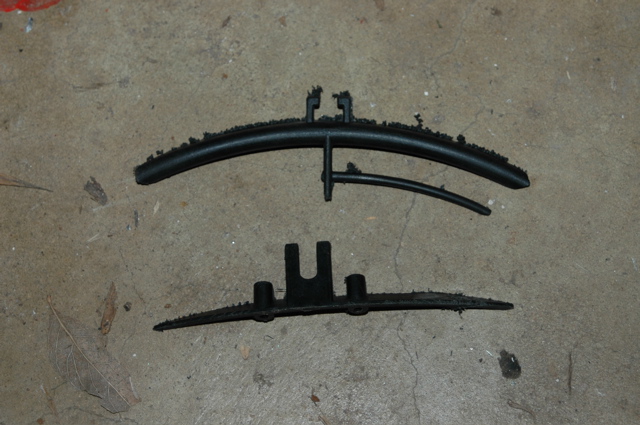

Inspired by this thread. I bought myself a birthday present on a whim... you guessed it, an electric fan. I pickied up an Imperial by Hayden pn# 226112 at Advance Auto for $65 and a thermo switch kit (pn# 226206) for $27. It's a 12" fan. The application chart did not reccomend the 10" for primary cooling and being as I live in Texas, I did not want to take chances. I had to cut off a little bit from the fan guard to make it fit. (pictured below) but I used a token saw and it was easy.
It'll be another month or so before I have it on the road. I will report back on whether or not it was a worthwhile investment. But I must say it is very nice being able to get my hands infront of the engine!

I was concerned with a 10 inch fan as that does appear to be rather small. I may end up picking up another fan later to install behind the radiator, if I can find one thin enough- and for under a hundred bucks.
I think you will be fine with the 10-inch fan. That is the size of fan they sell with the VB kits. Of course, CFM is more relevant than size. I was unable to find a CFM rating available for the fans at Advance Auto, so I went with the advice of their application chart. But at 1250 CFM, I think you are good to go.
