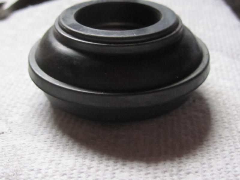

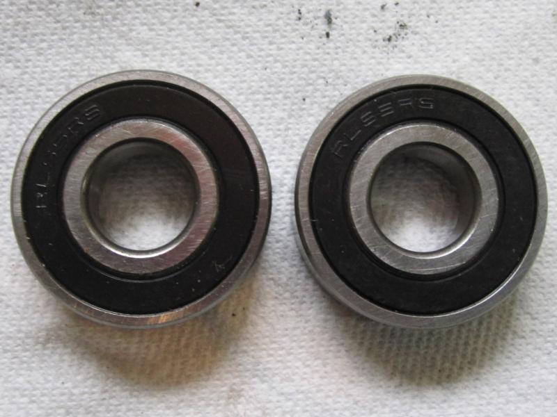

So, I decided to try rebuilding the original pumps. I found replacement bearings and a replacement seal (likely the hard part to find) in a kit provided by Michael Salter. His blog post is for the BJ8 water pumps, but he also has the kits for the earlier cars. https://www.netbug.net/blogmichael/?p=994
My first try did not meet with complete success as the pump still dripped a little. The reason for that probably was that the face of the impeller that runs against the carbon surface of the new seal was pitted and rough, allowing a little water to seep past. My initial efforts with a small file and fine sandpaper had not sufficiently smoothed the surface to allow for a good seal (see first pic below). Off came the pump again; it's amazing how much faster one can remove and reinstall parts after doing the same procedure a few times.
