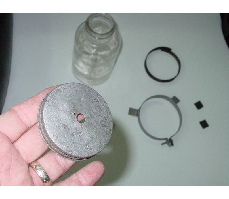

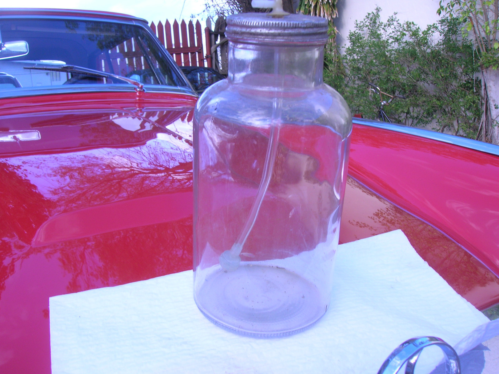

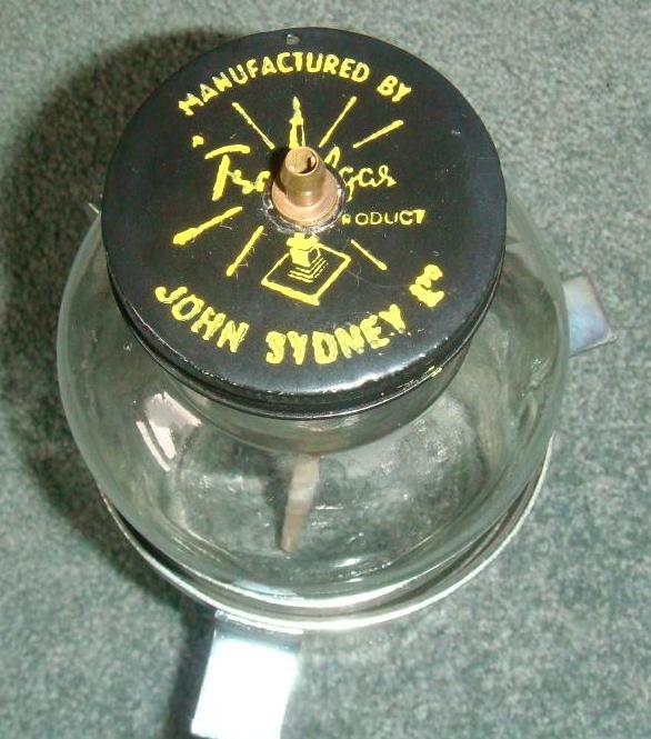

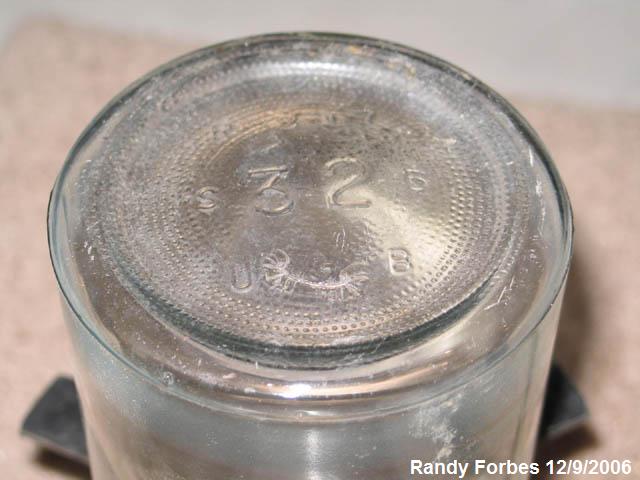

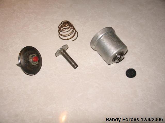

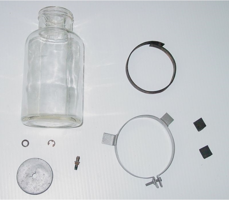

Francesco, I'm told that the nozzle is correct for a 100-6 built in Longbridge. The washer pump and water bottle are also different from the later cars. The bottle is glass instead of plastic.
My AH 100/6 1957 LONGBRIDGE Car -Have the Glass bottle (better than this in photos)

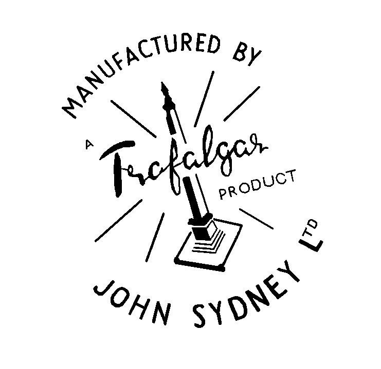

And I have also rebuilt the cap with paint of TRAFALG,
But I have never found the pictures at the moment
andrea
FIND THE Photos of the Glass BOTTLE right for Longbridge
First, the correct CAP and design. Last, the REPRODUCTION FOR restoring the cap
I think that all this material was from RANDY a very good friend

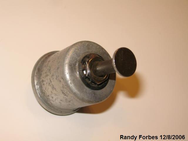

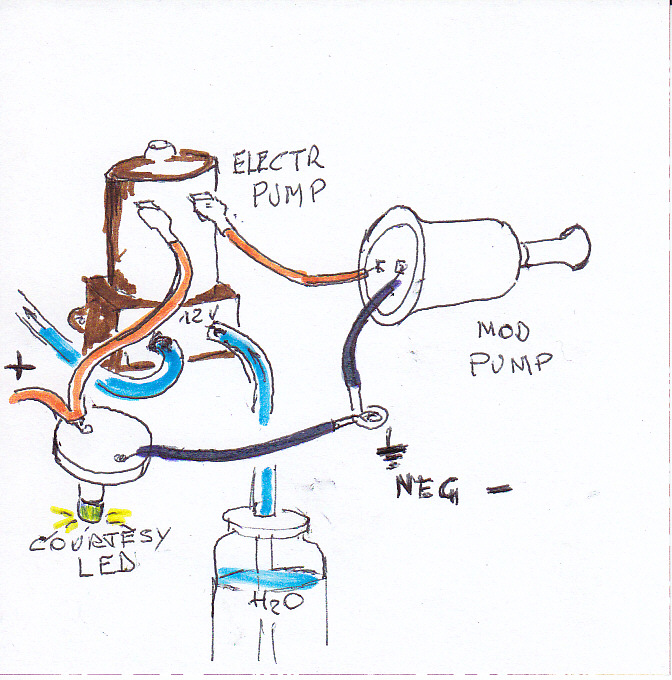

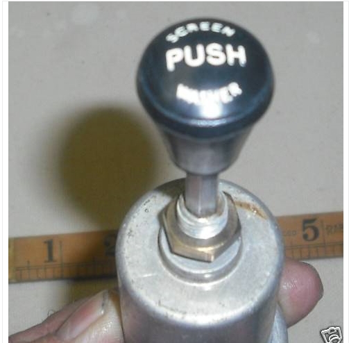

can be easily turned into an electric pump, maintaining the oldest-(My car is NEGATIVE heart car)
RANDY have a cromed PUSCHER on it MOD to electric - the old rubber can be destroyed

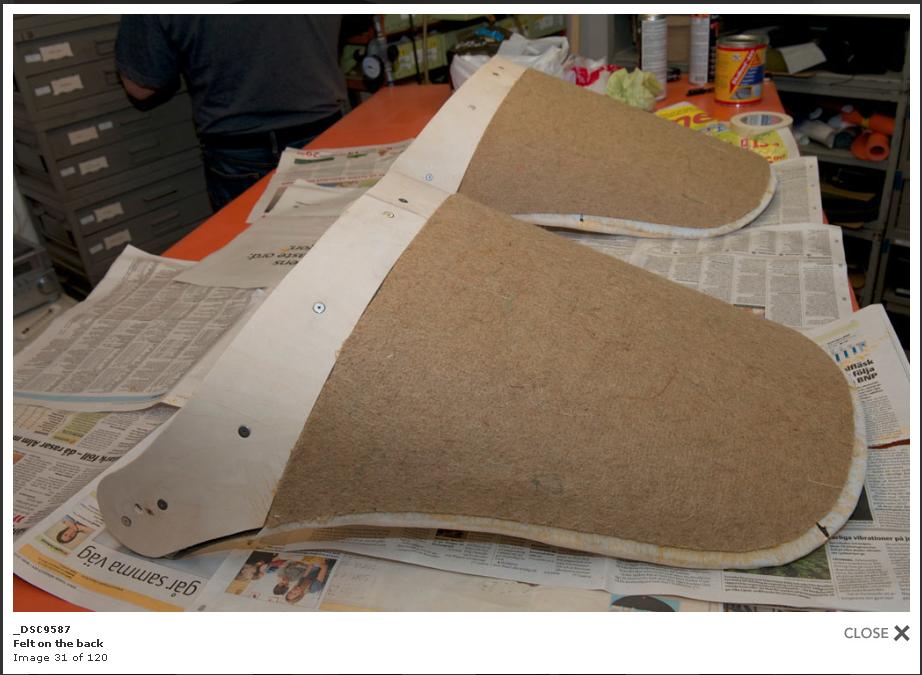

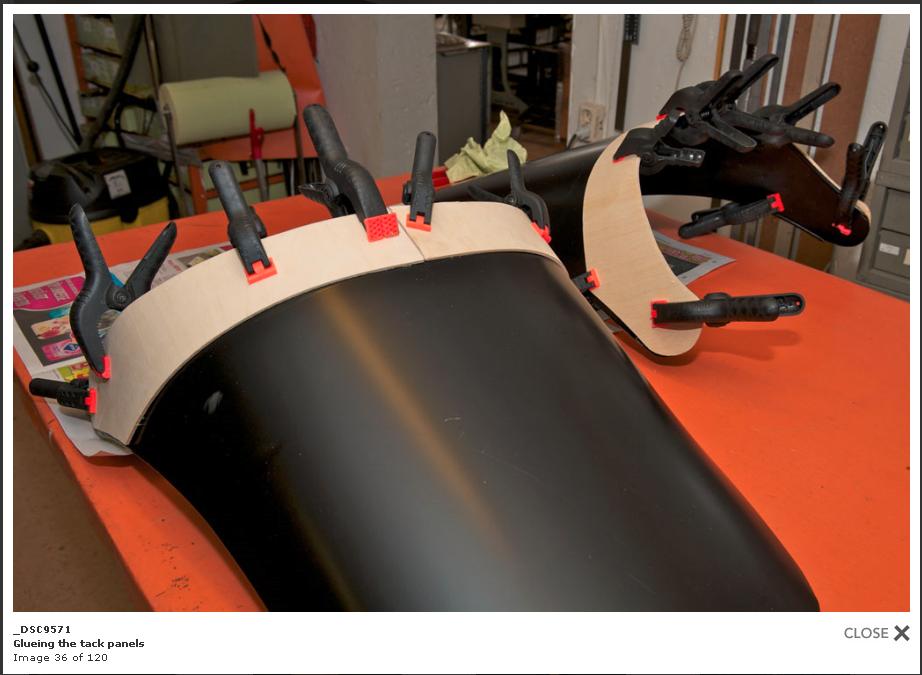

As you know, we're renovating a 1958 BN4 and have reached the point of needing to reupholster the seats.
My question is about the placement of the tack strips on the seat backs: should they be mounted inside the seat back or outside?
I'd be grateful if anyone could send me some explanatory photos.
Thanks in advance.
Francesco
P.S.: I'll post some progress photos soon.
I have found a grey soft layer at BRICO CENTER, but BORAS have utilized a better (FELTRO)
On my seat, I have found the 3 oldest liners in very bad conditions -PO don't remove it
