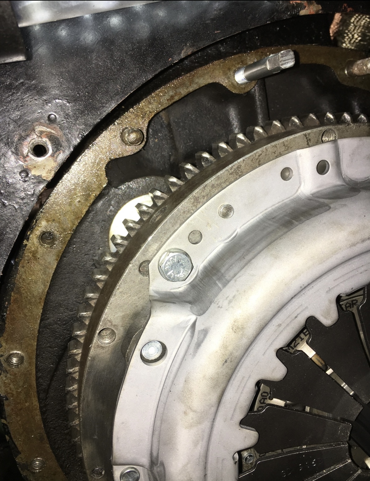

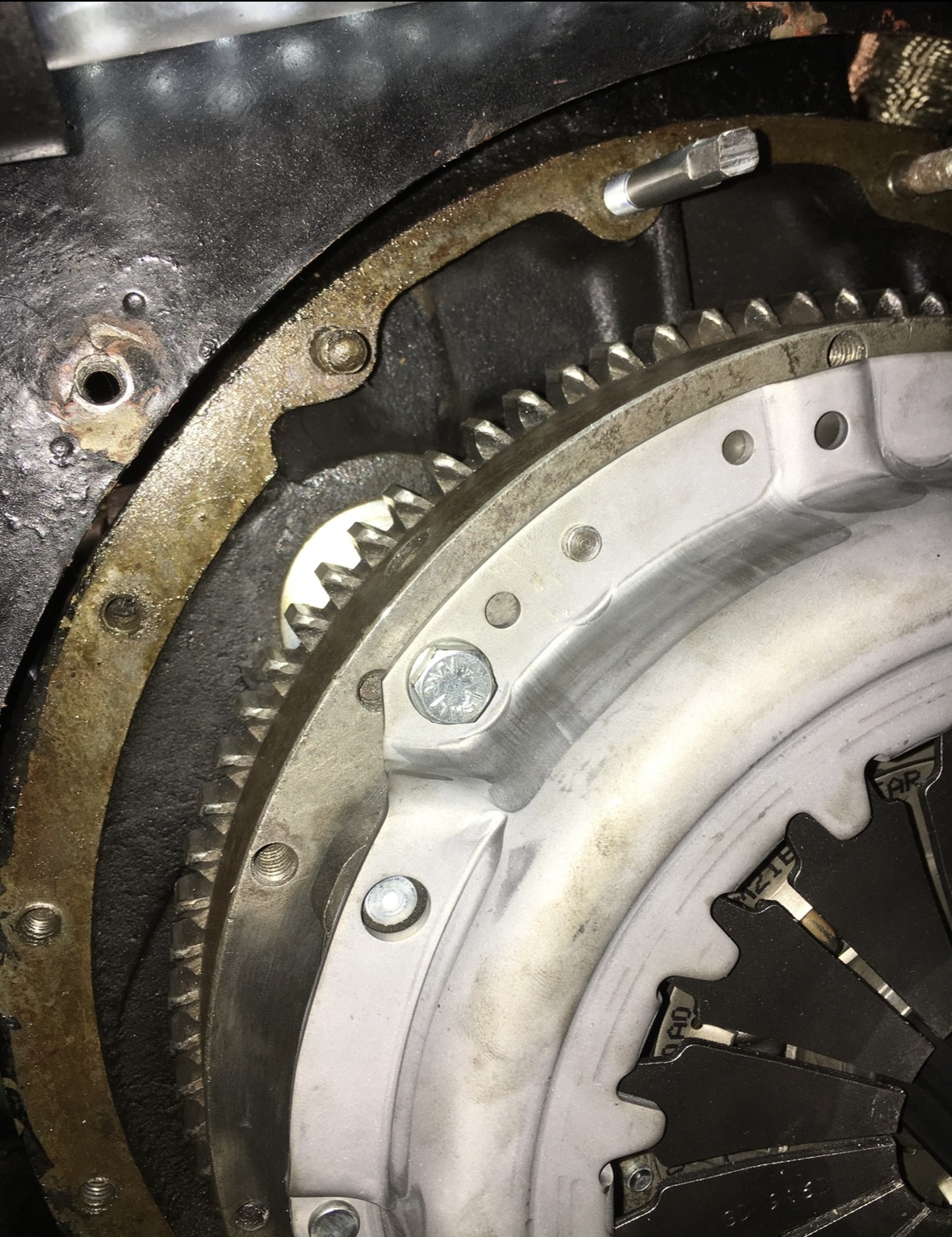

As suggested a 3” stud at the top will help you relocate the gearbox when refitting. You can literally hang the gear box off it and slide it home into the clutch.
This is my 3a with a 6 clutch and you can see the longer stud to hang the gearbox on. It’s a cut down long bolt filed so I can get a spanner /wrench on it to get it out.
All same principle on the 3a / 4 / 6
