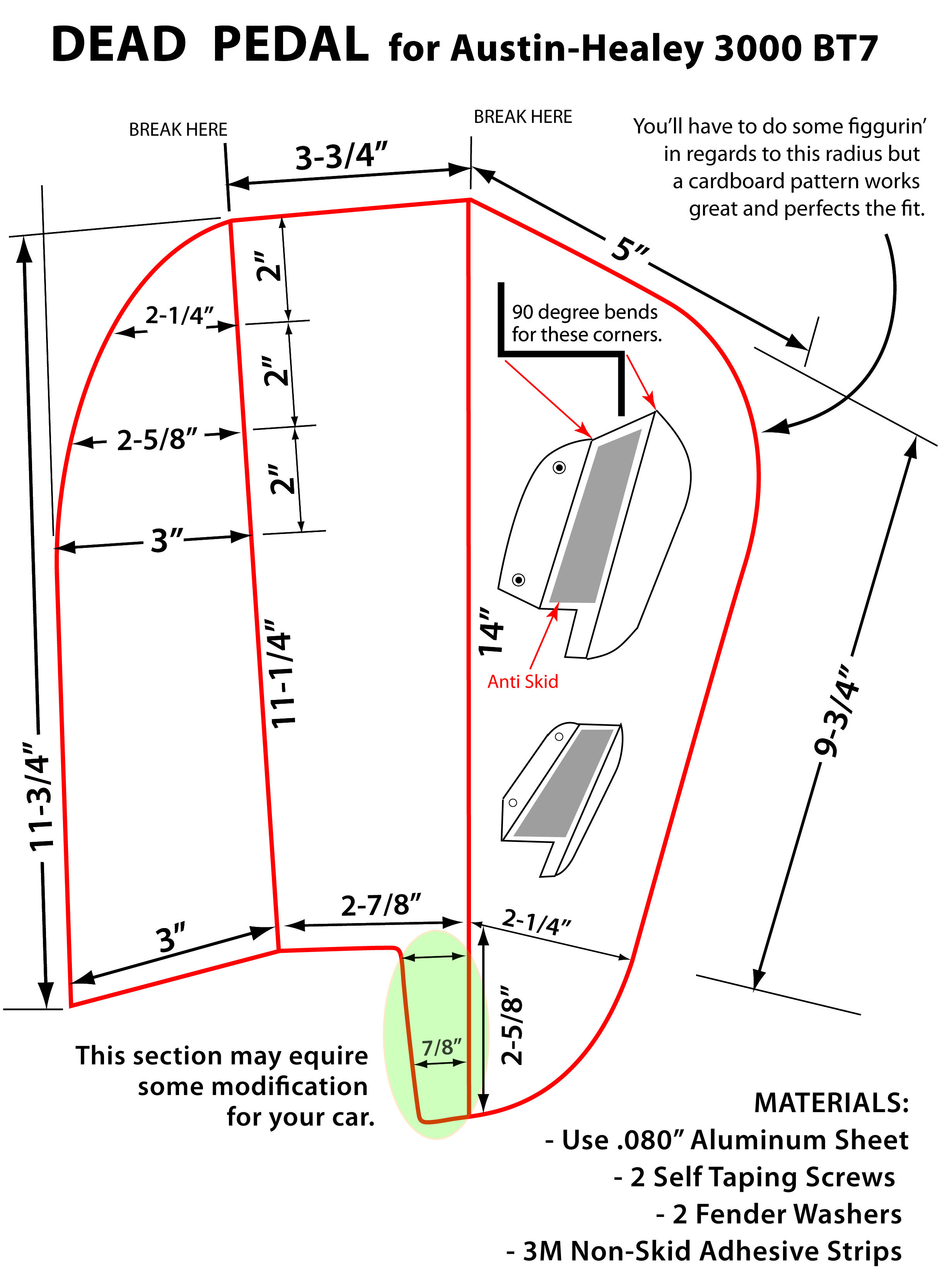

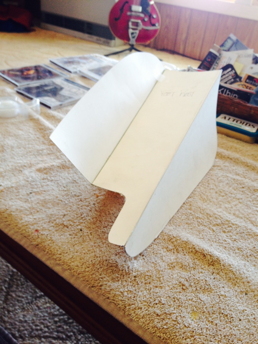

I was never completely comfortable while cornering because my left foot was always flopping around.
Following the racers lead I fabricated and installed a Dead Pedal that can be installed with 2 Self Tapping Screws and some 3M Non Skid strips. You can use some heavy paper to make a pattern.
Now I feel a degree of support that was sorely lacking.
