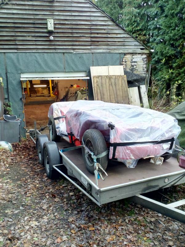

I am 75 years old and have recovered the part finished Healey on a trailer, brought it home to my garage together with a pile of dirty rusty rotting bits and pieces, with every intention of completing the restoration. It was a rolling chassis with all running gear, brakes engine etc overhauled but looking old from years of sat in a barn. The panels were not on the car except the loose front shroud that fitted comfortably strapped down in transit.
At home i did the first thing and put oil in but immediately found water dripping from a rusted sump. 2 Litres!! 30 years of standing in a barn! The drip stopped once the water ran out. Condensation?
Currently struggling with my aged bones getting under and around the car but progressing slowly. AH Spares supply wagon is in full use - carpet/boot sets, upholstery and panels all bought and fitted by me.

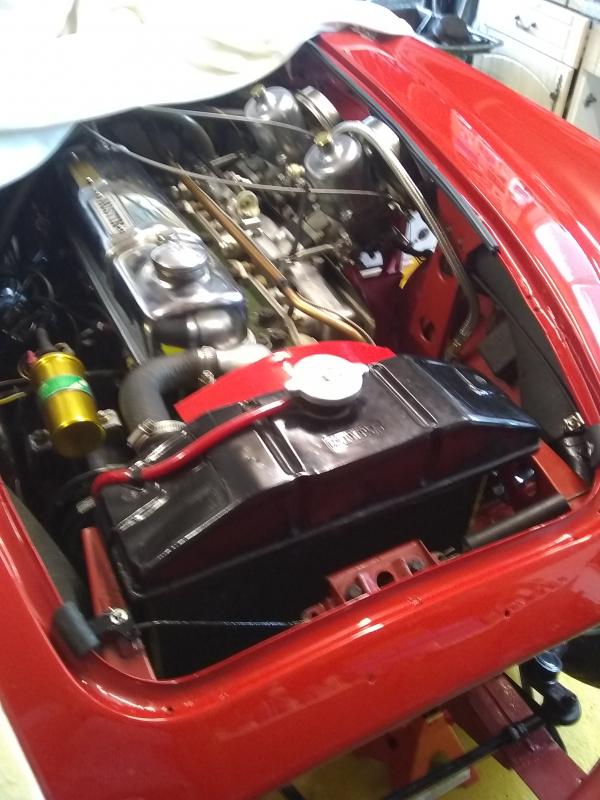

Got the engine fired up but blew three core plugs. Rusted out!

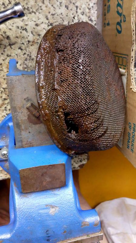

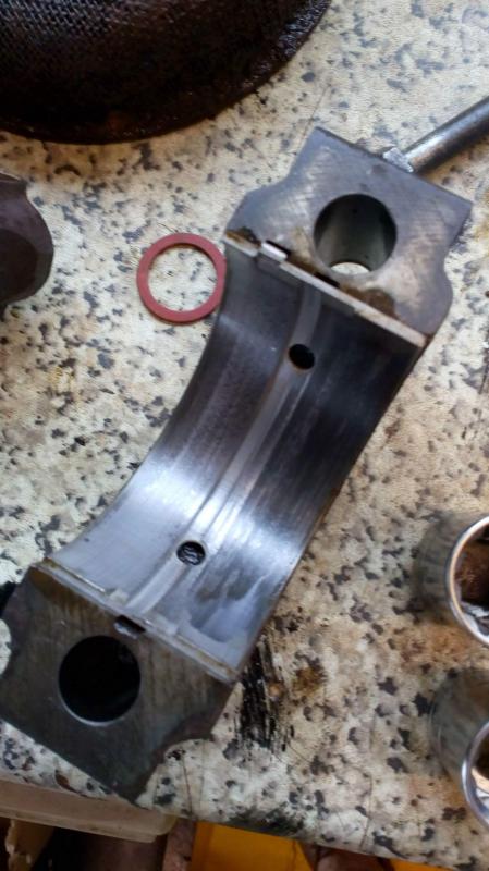

No oil pressure..... chose to remove the sump and saw it full of broken, rusted metal from rotting strainer and sump liner! Pump obviously useless. Sump has pin holes.
Took out one crank bearing shell and a conrod shell. They were marked but not too bad. Put them back in instead of subjecting any new ones to the rubbish that was going to still be in the engine oilways.

So...oil pressure problem ....installed new oil strainer and sump. Still no oil pressure.... so confused but went back to the friend Paul in Thailand who had the restoration before me (I call Paul my "midnight mechanic" because with the wonders of Whattsapp I am able to talk with him and share pictures at midnight here when he is 7 hours ahead in Thailand). He felt he may have put the flange modification to the oil filter 180Β° out. I checked that and he had! The evidence was that when removing the spinoff filter and starting the engine, the oil was coming through the middle of the filter rather than down its sides! Wrong!.. soon as I turned the conversion flange adapter 180Β° oil pressure was fantastic! Fired up at last. haven't heard that sound for 40 years. what a wonderful engine noise.

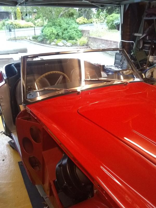

.... What a great moment!! Today at 3am (yes ..3am) I have fitted the windscreen wipers! Yes, I know, it doesn't seem so epic, but it follows two days of complete rebuild of windscreen assembly and its final installation.! One of the trickiest jobs I have experienced so far. Haynes manual followed to a letter, spacers bought for the support struts to body fitting. Sealant applied. Almost overlooked the attachment to the centre bracket.... I thought the centre hole in the shroud was of no use until JME restorers told me about the rubber insert including its thread for taking a centre fixing bolt was available from head4healeys. This was an item that was probably in the pile of bits I collected with the
car way back in December 2018.... and probably threw away!!

Oh oh!! Water leak! Found to be one of the rear engine set of three core/freezer plugs! The ones that you cannot get to without engine removal! Forum suggestions about creating a short compressing device arrangement between the bulkhead and block looks like my first move.... I really don't want to remove engine!
28 October 2019
Looking at the rubber freezer/core plugs as an option for the fix needed. Any ideas?? I think I will take that as my first option.

Well, my first look at the failing core plug issue previously highlighted revealed it will be impossible to replace, even with Dorman type plug, without lifting the bloody engine out!!! So now winter draws on,! antifreeze is in the engine, I never intended much driving of the Healey as yet, so this is a job on hold while I finish door fitting and hood restoration. Shame....
