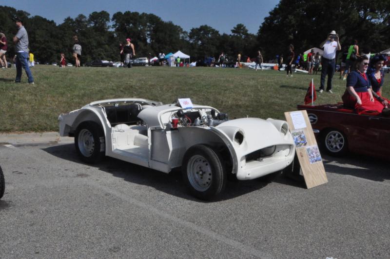

My first show was a trailer arrival. It is good for people to see what goes into getting these cars back on the road.

A SAGA OF DEDICATION WITH FRIENDS OVER 40 YEARS
17 August... So...oil pressure problem ....installed new oil strainer and sump. still no oil pressure so confused but went back to the friend who had the restoration before me and he felt he may have put the modification to the oil filter 180° out I checked that and he had .. soon as I changed it back oil pressure fantastic! Fired up at last. haven't heard that sound 4 years 40 years what a wonderful engine noise. there is huge classic/vintage car festival about 1600 cars this bank holiday Monday coming and mixture of loads of healeys, all the British cars American classics, Rollers all sorts of things. This was my original target date to show the car fully completed. I have an exhibitors pass for the day so now i intend taking it down there on a trailer. I think it would make a nice display and I would benefit from talking to like-minded people about the actual car itself so that I can move on with good ideas and tips to move forward.
