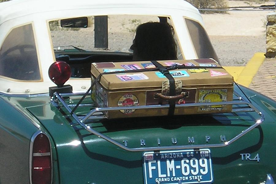

Seriously, that method of attachment was also used on stock ready-made luggage racks for the TR4 -- the layout of the hinges and license plate bolts and the way the bootlid reaches down to form the back of the body made it work on the Michelotti TRs.
Attached is a pic of the original-style rack as offered by Moss, et al.
TR3s also had a 'no holes' luggage rack mount but that required the use of suction cups or rubber feet for the rearward posts. Not as elegant a solution as the '4.
