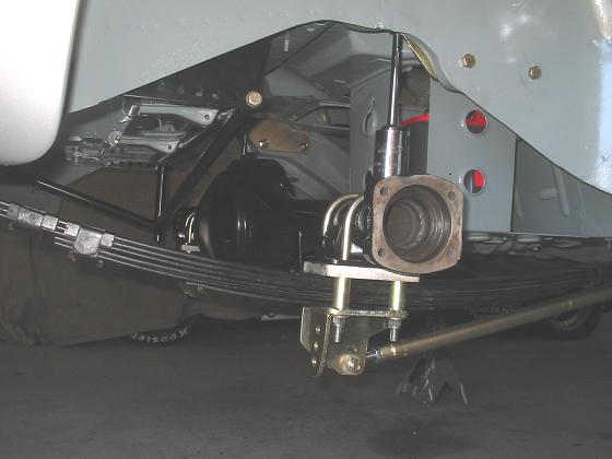

It's more commonly called a torque arm or third link, it's primary function it to keep the pinion angle the same under accelaration and braking. As far as leaf spring wrap you can take it one step further and do anti tramp bars, all my leaf spring set ups have anti tramp bars. In a normal leaf spring set up the leaf spring is ask to do two things be a spring and a trailer arm, so many racers go the anti tramp bar route. What the anti tramp bars are, are separate trailing arms added to aprox, the same pivot point of the front spring mount, then if you really want to do it right, you make spacer for the leaf spring bracket so when the leaf spring u bolts oare tight the they don't squezze the leaf spring, the anit tramp bars are now the trailing arm and the leaf spring experience no "wrapping" form acelleration or braking. Here's a phot of a anti-tram bar set up on a MGB race car we rstored, notice the spacers on the leaf spring bracket, they will not allow the spring to pinch clamped, if take the anti tramp bars off you can move the rear housing freely o the leaf springs.

Hap,
Where is the third link for that setup? Do you have a pic?
The third link is mounted on top of the top center of the rear housing just left of center and has a double shear mount on the chassis.
Yes the on the anti tramp bars they were mounted (best of memory, worked on too many race cars /bcforum/images/%%GRAEMLIN_URL%%/smile.gif ) best I can remember the spring bracket had been modified with a extra double shear mounting location for the front of the anti tramp bars. The front mounting point of the anti tramp bar needs to be reasonably close to the the pivot point of the leaf spring, if not on the same axis will eventually bind but if bind happens beyond suspension travel, it's a moot point because it will never travel that far.
