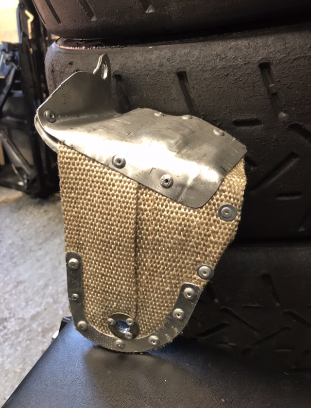

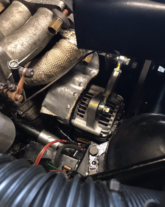

i also made an alternator heat shield and covered the Ali with exhaust wrap material
no issues to date.
no issues to date.
View attachment 97574View attachment 97575
I like that heat shield for the alternator. I think I'll make a similar one.:smile:(y)(y)
