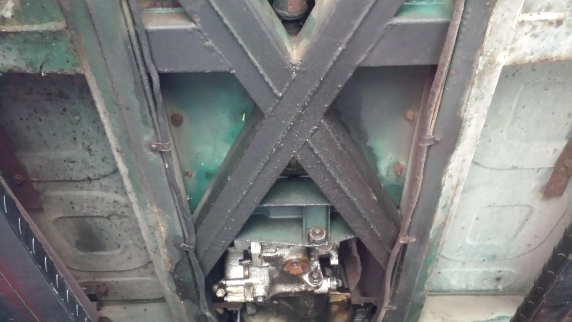

When I got the car home, I immediately put it on my lift to inspect the underside... and I have to report that it is unbelievably perfect. Most of the original green paint is still visible under a thin coating of grime and dust. No rust anywhere to be seen. I can't believe this car spent its 60 years in the Midwest. I'll post some pics of the underside later.

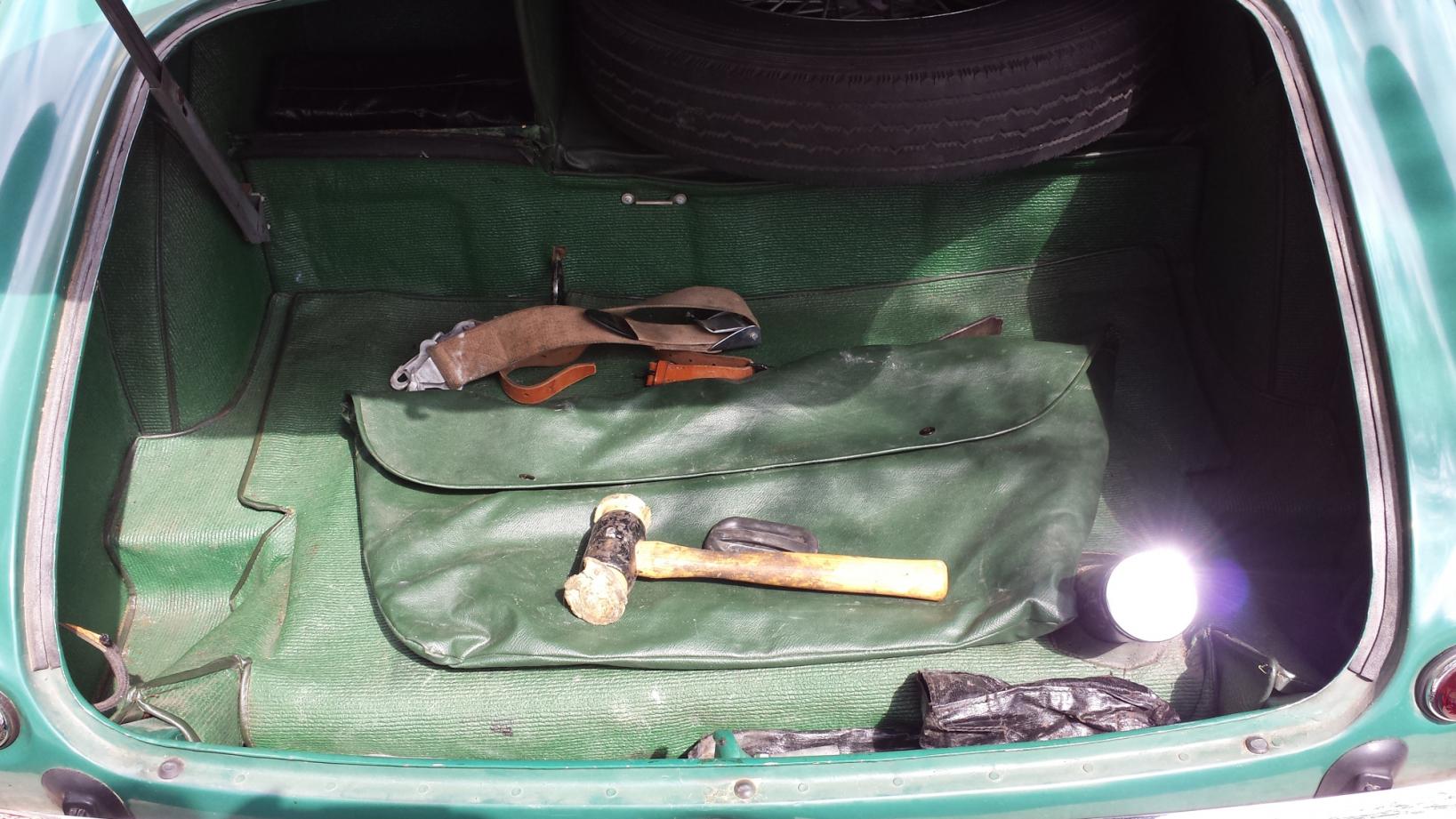

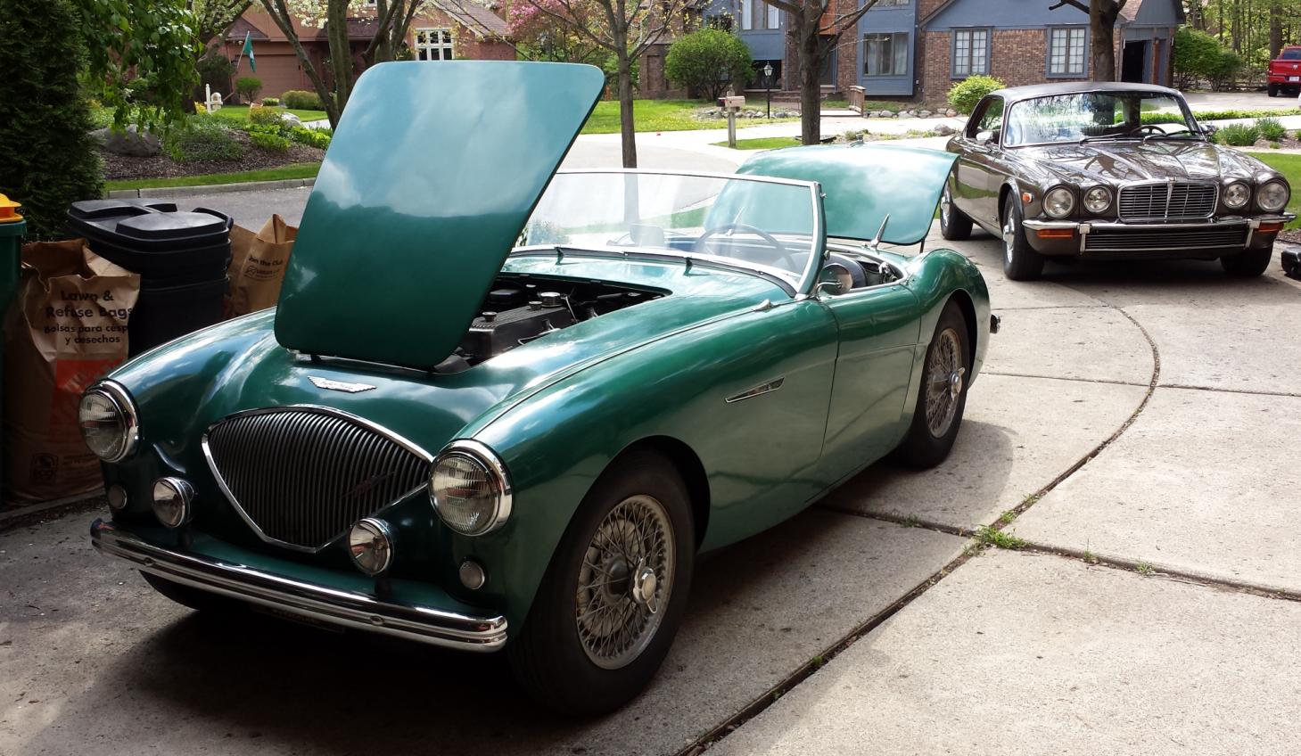

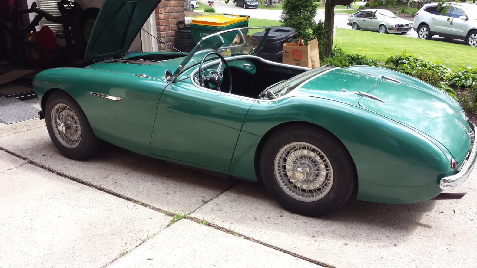

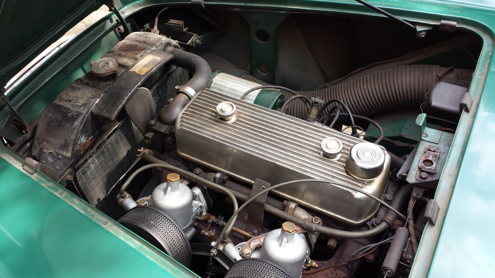

And I've added pictures that I promised a while back... I just can't believe how clean this car is underneath! underside_small.jpgboot_small.jpgengine_left.jpgleft_rr_34.jpgfront34_small2.jpg

Anybody have any idea what that bracket is between the carburettors, near the heater pipe??

I'm wondering what the bracket is as well that is between the carbs... only thing that comes to mind is that it may have been part of the hand controls that the previous owner had installed to drive the car. He had polio, and had limited use of his legs for most of the 50 years that he drove the Healey. That bracket may have supported a cable used to operate the throttle. All of the other equipment has been removed, but that's my guess if you guys don't recognize it.
