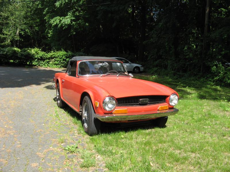

My '71 has a grille with no horizontal crossbar nor anything to attach it to- just the TR6 badge in the center of a black grid. I would post a picture but I'm technologically challenged. Was this a normal grille for that year? Does anyone else have a TR6 with that grille?

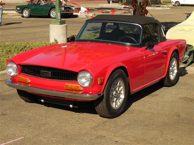

Thanks Marv - but there's nothing to attach it to. I'll try to send a picture. IMG_0572.jpg
There are two small tabs on each side of the grill with ahole in each that's where the bar attachés . If not,I have a whole grill as well.
Marv
Tr6easyrider
Your PO has made a few other changes. The windscreen frame would have been black, not body color and your windshield wipers need to be switched side to side.

It also appears that you might be missing the black finisher for the valance that goes under the grill... Moss part 854-205

Pretty sure it's there Elliot, looks to be painted
On second look you are probably right. Are the eyes the first thing to go?

pdplot
Valance is there - painted red by PO. Wipers switched? I never noticed, but I never drive in the rain - not for 18 years I've owned this TR. I'll change them over if they seem to wipe more surface that way. Finally, I'll check the grille for attachment points. I didn't find any the few times I looked. The car looked just the way it does now when I bought it but it had no wipers, a cooked alternator due to installing the battery backwards, a worn top, no windshield washer, and many electrical shorts. I did all the correction work myself, added a stainless steel exhaust system(by a local shop, not me), new brake lines, new window regulator and door check,new top (not installed by me), new alternator, tube shock conversion, rebuilt differential.. It wasn't running when I bought it - I had to tow it home with a rope and did the work in my garage where it still sits while my Honda sits outside, exposed to the elements. It's on its second battery and second set of brake pads.
