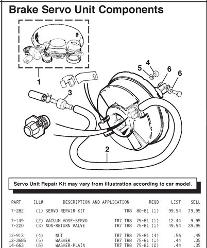

I don't see one. The vacuum line goes from the plenum (PI model) into the black inlet on the booster. Now my question would be why would I be hearing a hissing noise if the check valve is missing? I see in the Victoria British catalog that there is one available. They also have a rebuilt unit.

Do you mean the check valve? Victoria British shows it.
