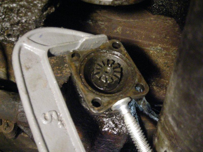

Just thought I'd post up how I got the nut off with almost no problem at all. The clamp around the pinion flange gave me the leverage I needed.
