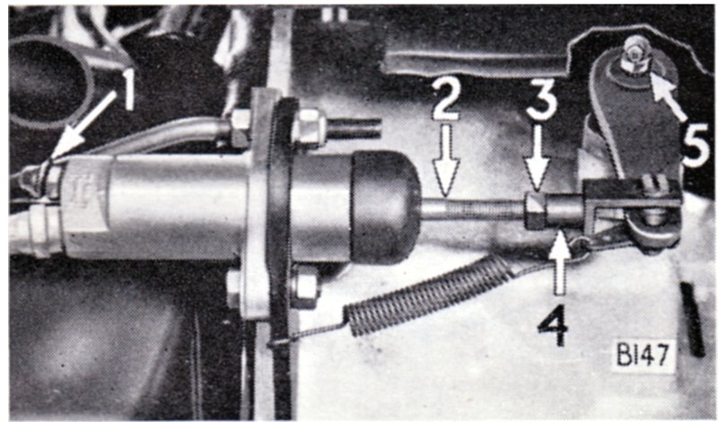

Ah yes, the Haynes strikes again! The illustration is only for TR2 and early TR3 with front drum brakes (and Lockheed hydraulics). As Bob says, the Girling slave was the same until the TR250.
But the important thing about the adjustment is that, with the slave piston fully bottomed in the bore, there is 0.1" or less of freeplay in the pushrod. I asked about it because I have seen symptoms very similar to yours, caused by having way too much freeplay but the slave piston is very slow to return all the way (because the spring is also too weak).
In turn, having way too much freeplay is sometimes caused by the dread broken taper pin. BTDT, got the greasy T-shirt.

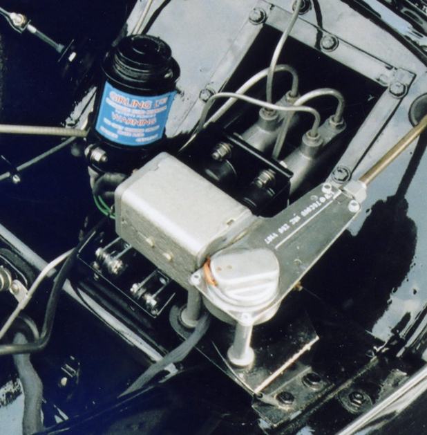

Don Elliott
There are two companies (Apple - who did one for me & another called White Post) who will install new bores in your existing master cylinders. If you go that route, be sure to also include the pistons so they can hone the bore to the correct inside diameter.
Guess how I found this out. Right ! I only asked for the new bore to be installed but didn't include the piston and had to hone it myself to fit the piston back into the new bore.
They put in a brass tubular bore 13 years ago with no issues since. Some advocate the stainless steel bore, I've got 13 years and 71,075 miles driven in my 1958 TR3A since 1998 with the brass bore.
For the rear brake pipes around the diff & rear springs, etc. send me a message with your e-mail address and I'll send you all my photos of this.
