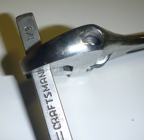

I made my own. Cut a short piece of 7/16" square bar (found at a local hardware store) and a 7/16" 8-point socket.
attachment.php
