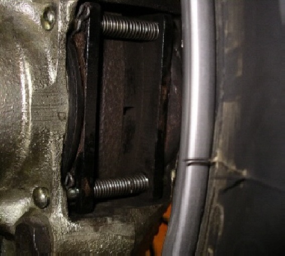

At LAST I've solved my tinkling noise, but feel a bit of a twit - the noise was from the FRONT PADS !!!!
Several people had had a listen, sat in the back and hung over each side (a feat in itself!) and all agreed it came from the rear right hand brake drum.
WRONG - it was the front pads on the right hand side rattling. As standard there are no anti-rattle springs fitted to these calipers as far as I can tell, but there are now on mine <g>
I found some compression springs just slightly larger bore than the retaining pins and 50% longer than the gap between the pads, and slid them on keeping the pads off the disk.
If you do this it is obviously ESSENTIAL that you ensure that the fully compressed length of the spring is shorter than the gap between almost worn down pads or the brakes won't work !!!
It took maybe 10 mins to do both sides, and when I think I've stripped out the rear drums three times, made teflon replacements for the felt steady post pads, replaced the spring retainers for the sliding rear brake cylinders in a vain attempt to cure this noise it gives me a wry smile !
