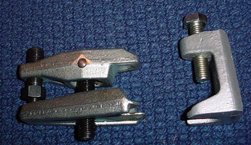

Alan_Myers
Hi,
I've got a drawer full of tie rod tools. Wouldn't you know, the cheapest one is the one I use the most. It just works every time...
www.jcwhitney.com
part ZX881770B
$11
Also works well on ball joints, shock links & more.
No hammering or torching needed.
Alan Myers
San Jose, Calif.

Hi Alan,
I have also had good luck with this tool. JCW #ZX881770B.
D
Keoke
Thats the tool I initially suggested and it works every time---Keoke /ubbthreads/images/graemlins/yesnod.gif
Dave Russell
Yoda - R.I.P
I have both types. Sometimes the smaller cheap one is easier to get into tight places such as tie rod ends. Depends on what you are using it for. See attached pic.
D
