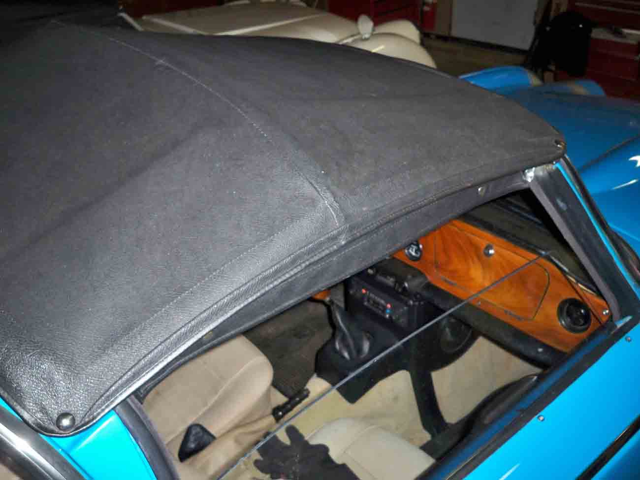

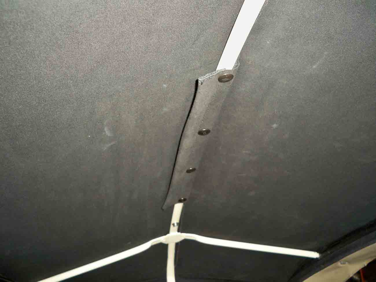

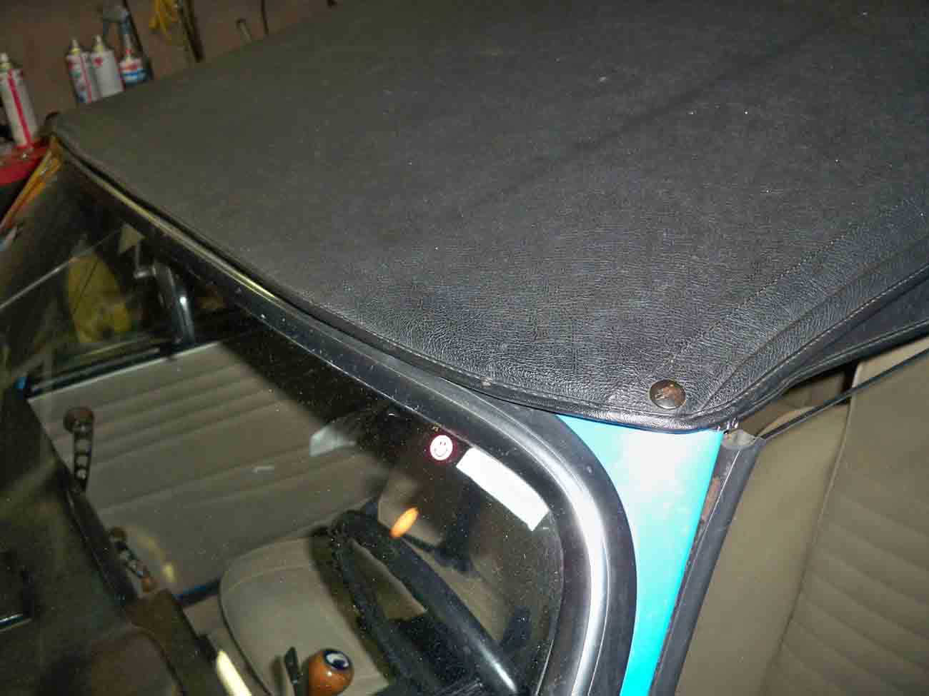

Got_All_4
The only place there are 4 snaps together is inside the top that holds it to the sticks.
There is 1 snap in all 4 corners and one more inside the drip edge above the center of the driver and passenger windows.
They are correct in the surrey top slides under the ridge on the windshield cap and then snaps on each corner.
I'll send 3 separate pics of my top on my TR250.
