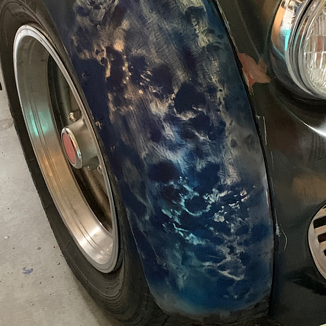

Just removed a ton of filler from the front wings.
does everyone know how you get dents like this ?
I’m miffed.

Looks like someone pounded out a large dent using a claw hammer and a 2x4.
You have to remember there was a time when these were just used cars - and not particularly valued used cars at that.
CJD
Perfect example of someone doing bodywork with no knowledge of how to do it right.
Hamish Racing
Yes I’m afraid it’s most likely a diy repair probably to an already secondhand wing ( fender?).
May be in the1970’s when filler was cheap and spare (metal) ones relatively expensive.
my car ran into the back of a truck in the 1970’s sold damaged and the man I bought it off was a student - thus poor replaced the panels with fibreglass ones. Used as a daily driver.
He later rebuilt it very well with real panels. He had the car 45 years and 2 rebuilds.
you either need to set to with hammer and dolly - give it to a man who can it will come right with time and patience or replace it. ( or the filler route again )

Large hail or someone with a little ball-peen hammer! :hammer2: :jester:

I just repaired one that looked just like that. I would guess that the fender was a whole lot worse before somebody worked on it. They may have gotten what they considered the worst of the dents out. So what you are left with is a lot less than where it started. The good news is that with more work you can get it pretty close to original.
Charley
Sarastro
I agree with the consensus, except that it might not be a DIY repair. I have found that a lot of body shops just do a quick job of pounding out the dent, then slop on the bondo. It looks OK to the customer and probably will last well past the end of the warranty period.
The trunk lid on my TR looked nice and smooth (from the outside, at least) but when I took off the paint and filler, it looked like dents had been pounded out with a pickaxe.
Jerry
My TR3 had a dent I could put my fist into it.
And I wear XXL gloves. They could have pounded it out in 10 min but as said above, bondo was cheaper.

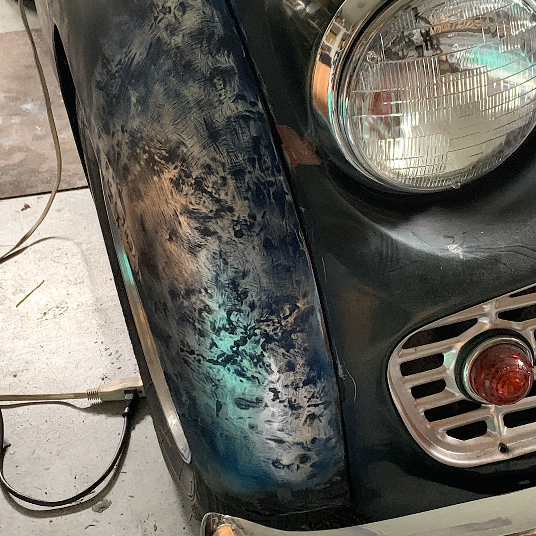

Another suggestion that might be worth looking into is the stainless shrinking disk. They are available in a version for 4 1/2" grinders and 7" grinders. I have used one on my 4 1/2" grinder and find it a very useful tool.Since there has been so much beating on the wing it is surely stretched a lot and shrinking will help bring it back to shape. Frank

Shrinking disk...interesting. I guess it is doing what a torch does, but keeping it much more localized.
Frank Canale
Yes it heats high spots and shrinks them and leaves the low spots alone. I found it easier to control than a torch. It also does the locating for you rather than feeling for the high spot then heat that spot and shrink. It is not fast but that is good if you are new to body work. The disk just like a torch, you can over shrink an area and have to hammer and dolly it back out. I find it to be a useful tool as shrinking is difficult to do once you get away from the edges. Frank
CJD
Thanks, Frank...something new to try. I still remember spending 3 weeks trying to shrink an arear of my bonnet. Every time I shrunk one spot, the oil canning moved to another. Next job I'll give the disk a try!
