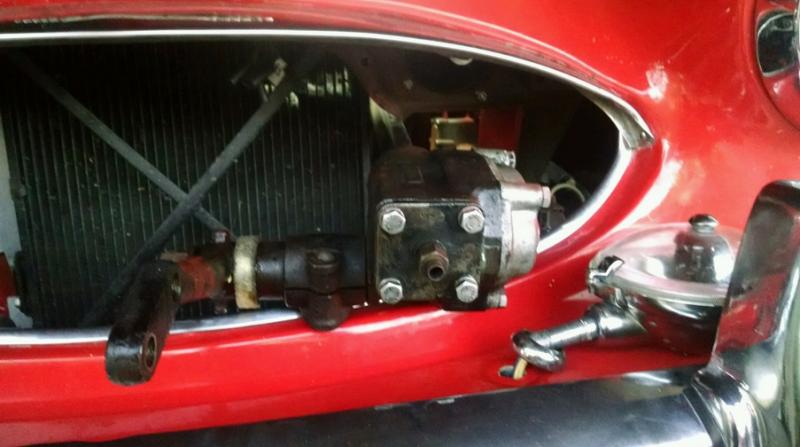

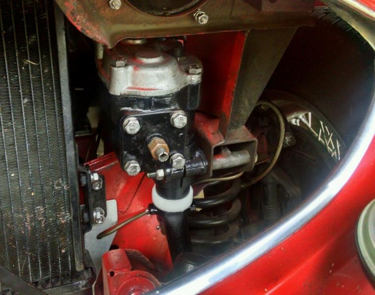

Box reinstalled:
Box extraction: After extracting the box, I removed the pittman arm on the bench. I reinstalled the box minus the pittman arm which was easy to install from below.
