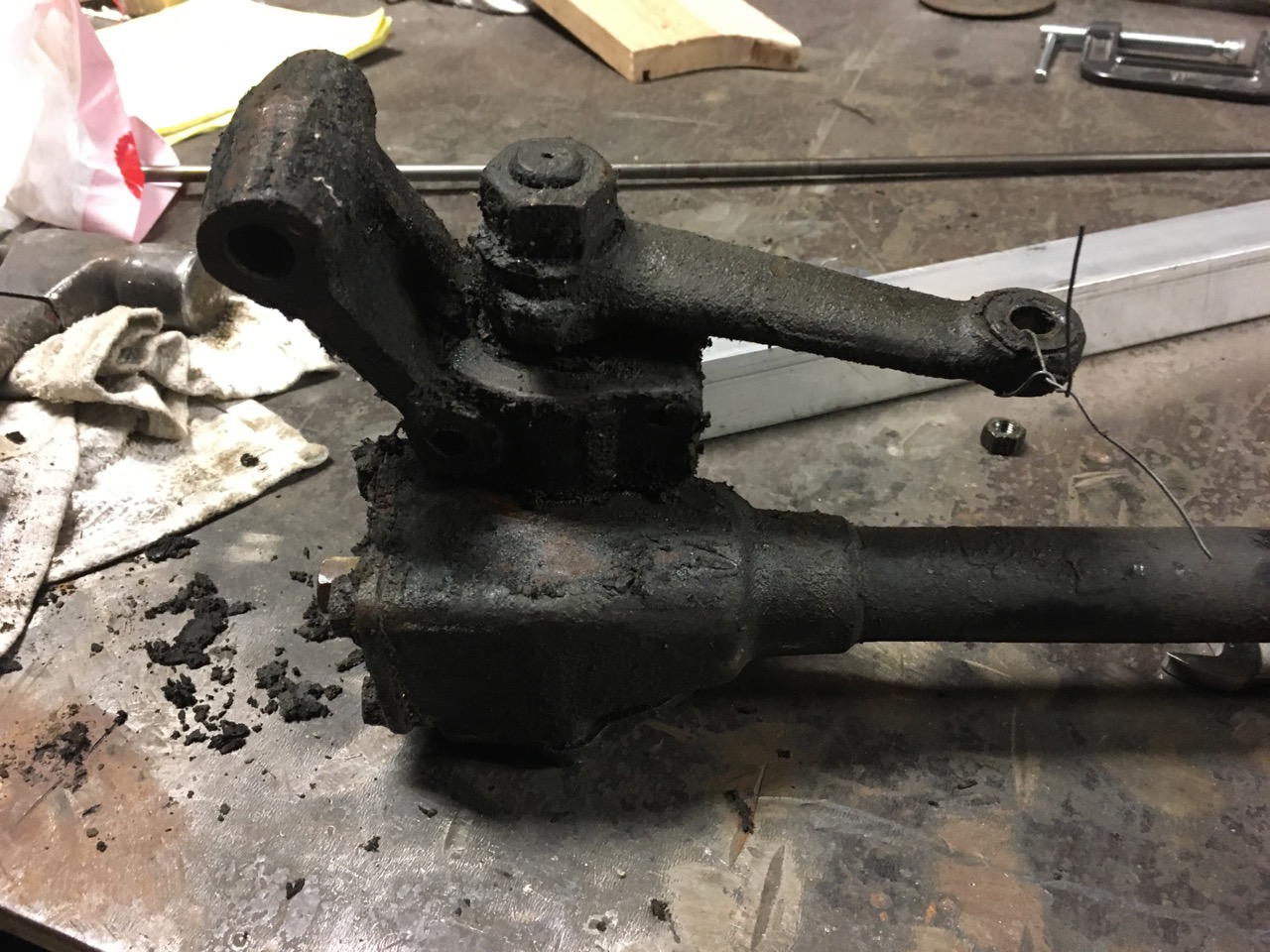

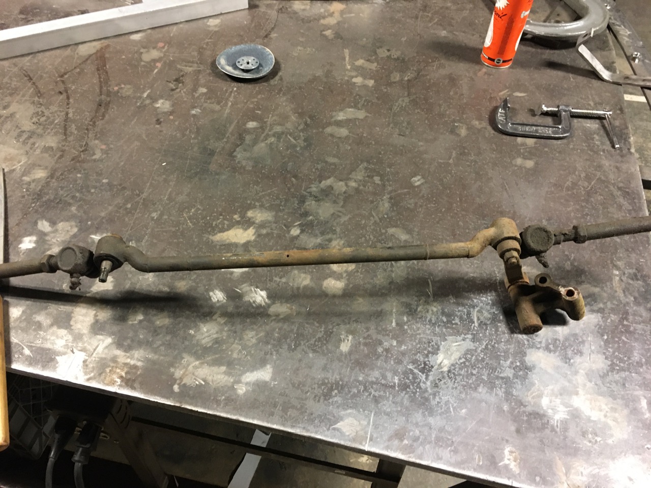

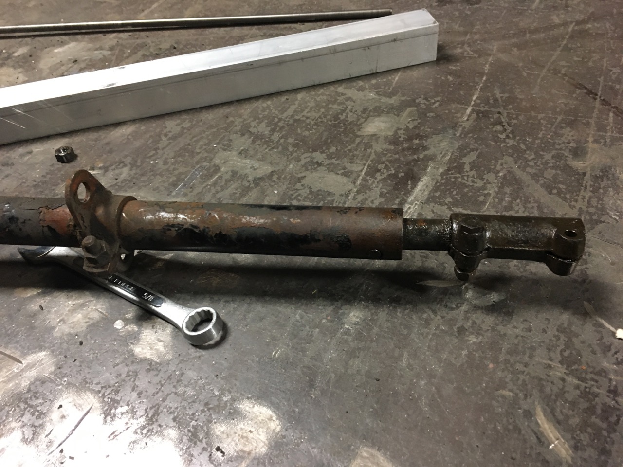

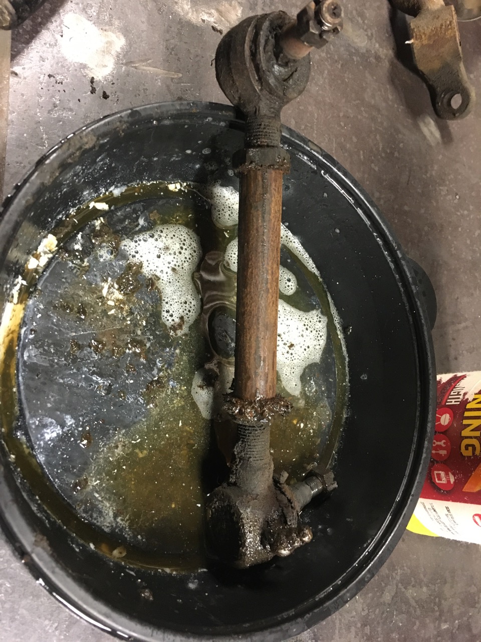

I am using this post as motivation to make some progress other that on sheet metal repairs. Decided to tackle cleaning up steering box and attached steering linkage. Really grungy but so far no real surprises. I could use some advice on the steering pin. The steering box had very little gear oil in it and as I turned the steering shaft I was not able to detect any resistance at center. Everything moved freely but I would not say that it was sloppy either. The worm gear at the end of the steering shaft does not show any sign of wear or scoring but there does look to be some surface pitting on one face of the worm gear. The peg does show very minor wear and was wondering if it best to press the peg out and replace it with a new one or rotate the original one. The bushing in the steering box shows a good .004" of wear and I have removed it and plan to replace it and ream it to match the shaft. The stator tube was broken off at the top so it will need to be replaced. The lantern bearing is in excellent shape. The rubber bearing/ bushing that supports the upper end of the steering shaft just below the splined connection has mushy rubber so I plan to replace it. Center drag link has minor wear in the center where it has been rubbing on something. I pressed out the rubber silentbloc and plan on going with the delrin silentbloc replacement. The tie rod ends look to be in very bad shape so I will be replacing them. Everything is bead blasted good as new and ready to start putting back together when I get replacement parts. The mechanical side is more to my liking so a nice change of pace. Frank

Wow...a non-bodywork item to check off!
I would probably just turn your current peg, as it is impossible to tell if the latest repro parts were heat treated properly, and there has been a history of some "soft" pegs. It doesn't take much wear for the center "bump" to get lost. Turning the peg and adjusting the box should bring it back.
If you use the main bushings from the big 3, they usually don't need to be reamed.
The wear on the center of the cross link is where it only has about 1/4" on the fan extension. If it rubs all the time, don't be afraid to bend it a hair to lower it away from the extension if you need to.
You've probably read my other posts, but the key to a good rebuild is to set the shim stack to get absolutely no play in the worm gear...but not so tight that the worm bearings start to drag. Then take up the slack with the top adjuster until you just feel the drag across center when hand turning the steering shaft. That gets all the play out without adding any internal friction.
