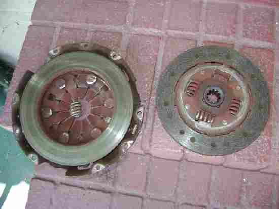

Don_R
Don_R
WELL THERES THE PROBLEM
Transectomy completed.....
Don_R
Don_R
Borg and Beck....
friction material is sbout wore out....time for a change....
I have a AP 20 spline steup for the O/D trans...
all I need is a new trans mount and possible a new cable....have a used one but it looks like the existing cable is long enough...
odd thing i noticed...the cover was bolted on with 3 allen head bolts and 3 hex head bolts...
