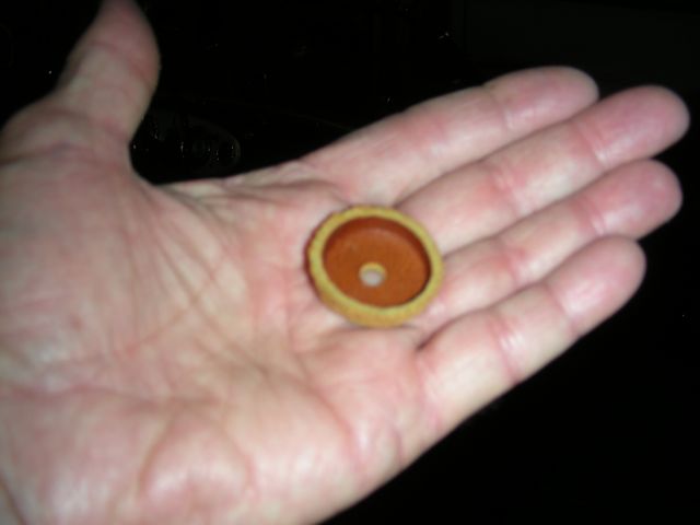

They come in 1/8" increments. This is 1 1/8' and I think it would work for you. My pump measures 1 5/16" so I got an 1 1/4" and after I soaked it in neatsfoot oil, it works great. PM your mailing address and I'll send it to you.
Marv J

Thanks for the parts, Marv. It was so nice of you to go out of your way to help someone you don't even know. More work on the tire pump, but I think the leather cup will work perfectly.
