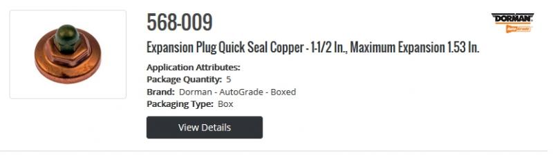

I like the Dorman expandable copper freeze plugs vs the rubber ones, which are often considered temporary.
https://www.dormanproducts.com/c-353-expansion-plugs-quick-seal-copper.aspx
Jim 58 BN6

Note: I just saw Steve's expandable plug, so if I could get to the bad plug, without pulling the head, I would try that first!
