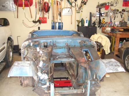

Re: Silly question-- Where do the washer squirters
Gotta install that setup next...does anybody have a photo of how the lines go in the engine compartment of an early car...from the firewall up to the washer bottle in the front of the driver corner of the engine comaprtment?
Yep, I forgot to take photos of mine!
HAN8L1965
Tony, here are two ugly pics but it shows the tubing running along the master-cylinder and running just to the left of the hood hanger to the front
Mark

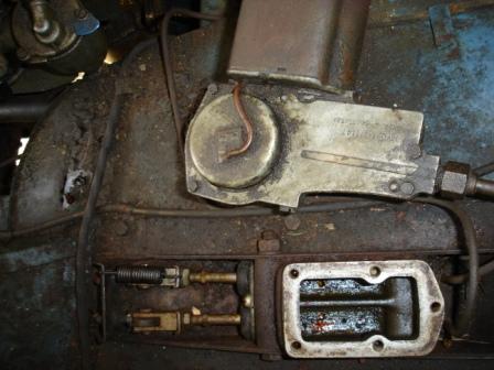

Thanks, Mark - do you have one showing where it comes out the firewall?
jlaird
Small, very small hole with a rubber gromet just above the wiper motor and to the side of where it goes through the fire wall.
jlaird
Yes, hay Tony use this pic.
tony barnhill
Great Pumpkin - R.I.P
Oh, man, is that good! Hopefully, there's no changes from the Bugeye to the MkI Midget!
jlaird
No changes Tony.
tony barnhill
Well, that's one of the best tools I've seen yet - answered many of my questions!!
jlaird
I think we have all used it over the years. No clue where it came from.
