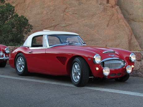

Keoke, now now... beauty is in the eye of the beholder... and to my eye the side vents, when properly done, enhance the look. Of course, I have seen them done badly and then they can be ugly. But, for me, growing up looking at Works Rally cars take on the European rallies they had a special appeal.. the Works cars ..purposeful, tough, hairy chested cars... ran them and I loved them.
Dave, I have them on my car and have not seen a downside. As Keoke, subtly points out, they can detract if not done properly (I think that's what he was saying :yesnod:)... and on that note, I've seen as many done poorly as those done well. Unless you have an engine leaking fluids that could work there way to the vents I can't imagine a issue. Healey's have alot of under hood heat that is just screaming to get out... so why not let it out :thumbsup: !!
Here is how I did mine Works Rally side vent project

Thanks guys. I understand both your points of view, that's why I asked the question.
Steve, you did a super job on yours. That's the way I think they should be done. But your pictures show me that they are considerably larger that I thought. I have never seen them in real life. The advantage of evacuating heat is important that is why I am considering it. Not sure about the size. Not sure I want to go to such an unoriginal appearance, even though they are works designs.

Dave, mine are actually smaller than most... why?... because Kilmartin sells them and they were 1" bigger than the Pat Moss Works Rally car that I took a rubbing from ... so I cut the Kilmartin's down 1" and recontoured them slightly to match Pat Moss's.

Having seen Steve's side vents first hand, I think they look quite nice. As with everything Steve does, the installation was extremely well thought out and executed.
