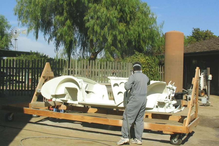

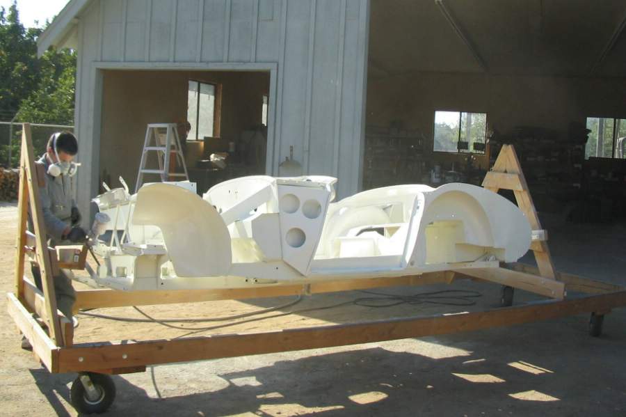

I doesn,t take much if the drive train is out. I built one for painting the bottom of the car, and then rearranged some of the boards and remade it for painting the top side.

Frames like shown in the previous post are probably a better idea than saw horses. They'll allow you to much easier move the car around of/as needed. Used something like that for a Sunbeam tub so I could get room around it to work yet push it into a corner when done for the day.
That must've driven those Poche' Bridge folks crazy; I'll bet they thought you were going to have a [SIZE=+1]Cochon de Lait!

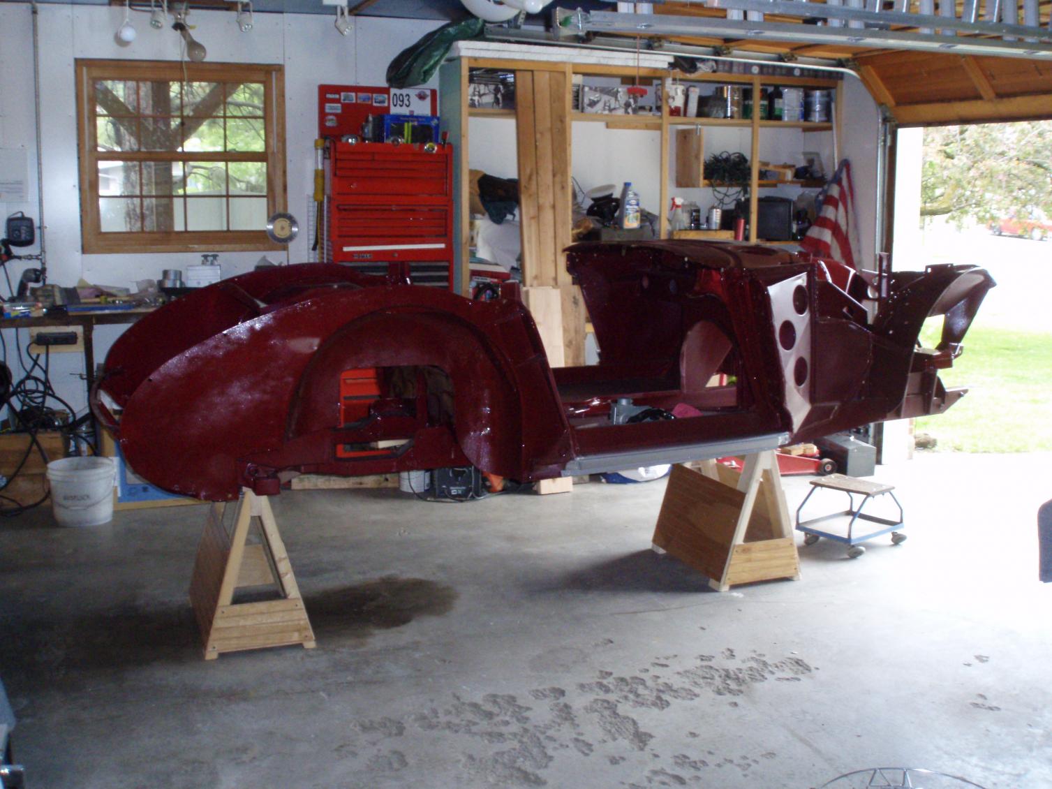

137.jpg123.jpgThese are supporting my BJ7 right now. Made with 2x4 legs and a 2x4 cap laid flat on top. All bolted together at top where legs and cap come together. Face and sides reinforced with plywood glued and screwed to legs. Saw horses are just a few inches wider than frame rails. Griz

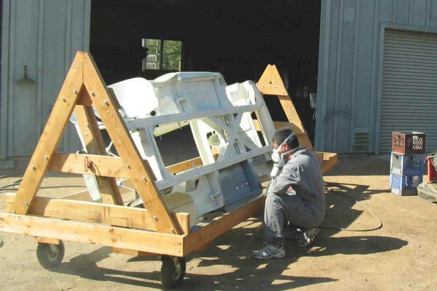

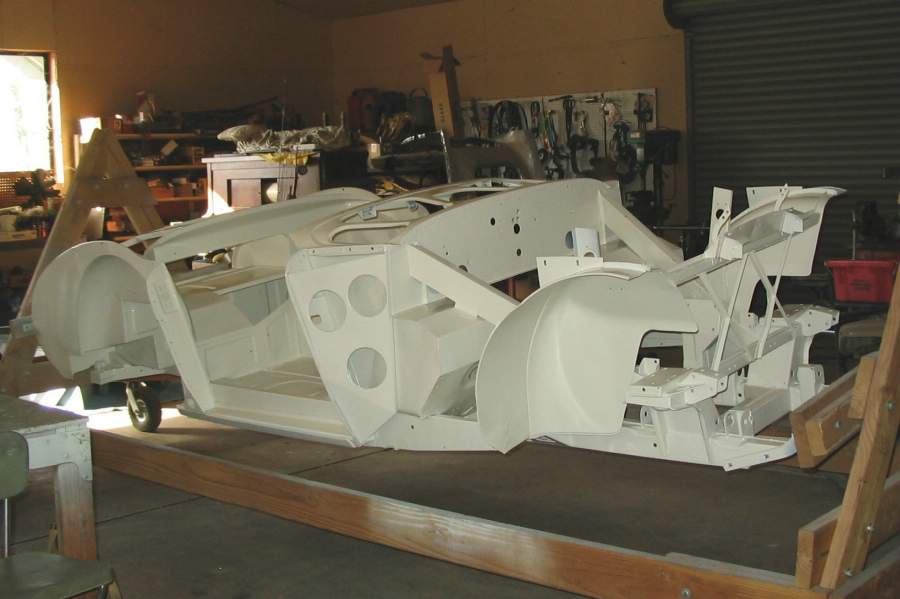

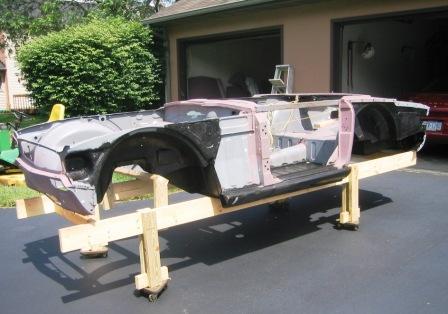

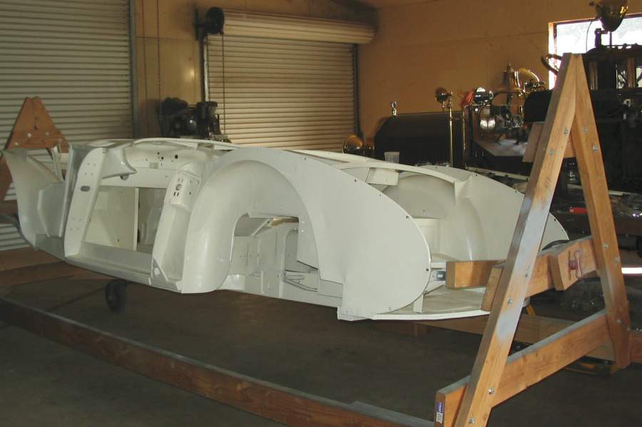

I built two frames for my TR6: one to be able to rotate the body, and one that gave me mobility.

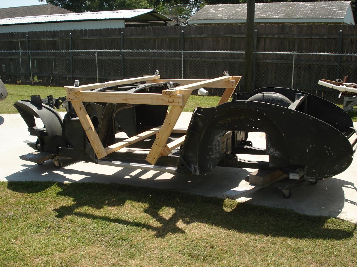

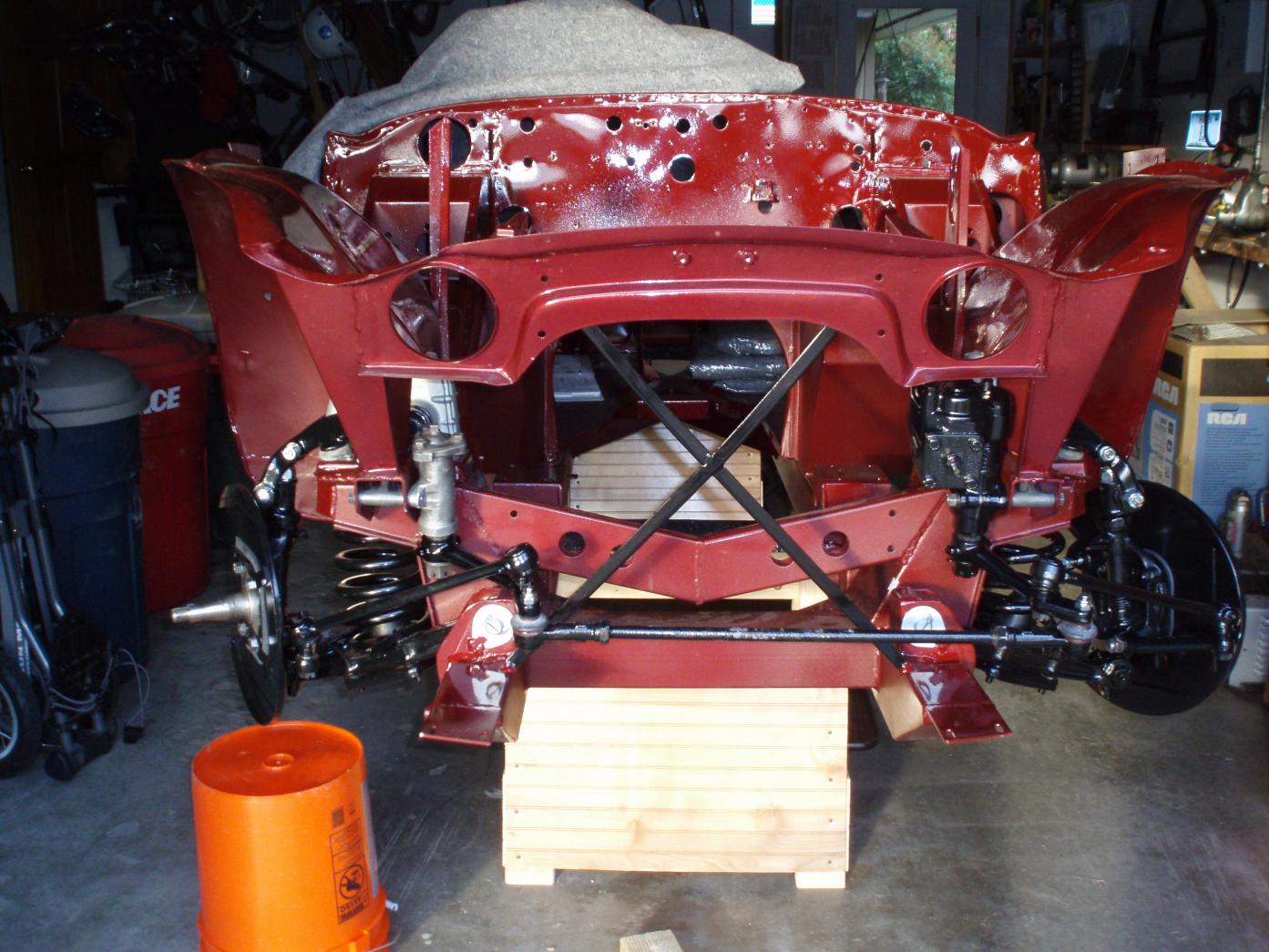

Here's what I built to support my BT7. Although it looks like it might be teetery, it wasn't, and the small footprint made it easy to work under the car.

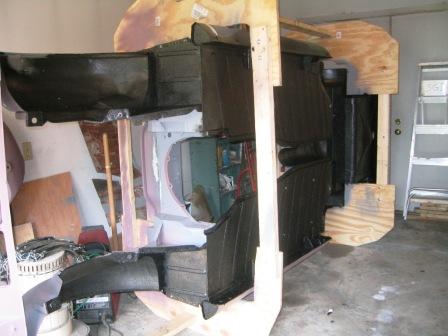

As I remember, someone on the forum built a wooden rotisserie frame that attached to the bumper bracket holes in the frame and allowed the car frame to be rotated 360 degrees. It was completely made of wood, not the normal metal engine stands. Does anyone remember the post and where to find it. I've searched but haven't located it yet. I would like to build one for my restoration.
Also, what is the weight of a stripped frame and substructure?
RestoreThemAll

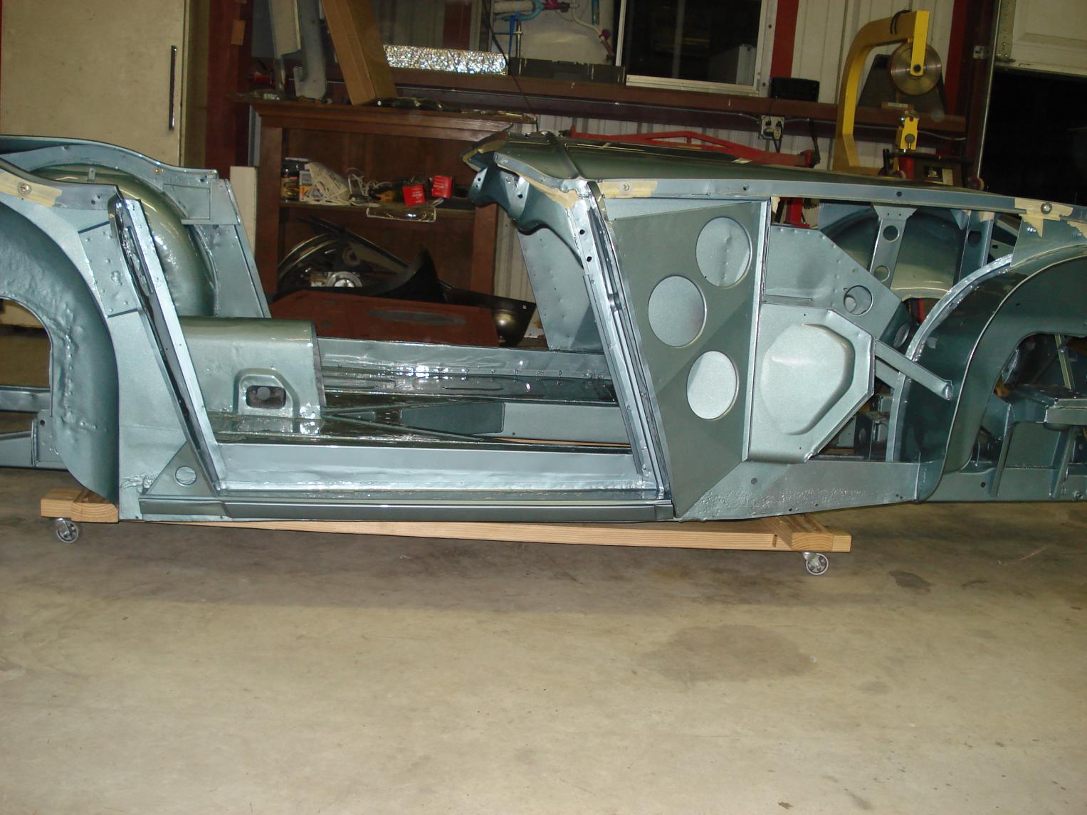

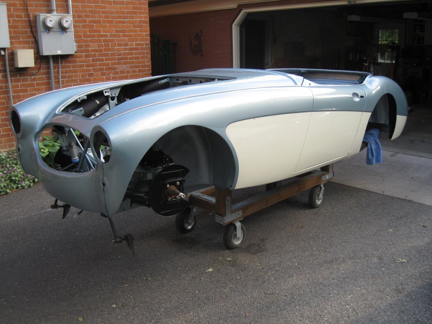

Furniture dollies are cheap. Mine is sitting on two 1,000 pound dollies with concrete blocks on top, separated by plywood. Very quick and easy. I move it all over the garage.
Might have been me.
