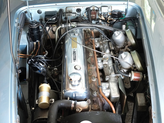

I probably should have posted this before, but with an inexpensive filter like this in the line, you needn't worry about anything in the tank.

Just my observation but the filter is best placed just after the fuel pump (and mark the date installed with a Sharpie on the filter). I had frequent vapor lock after runs on hot days. I had a plastic filter mounted under the bonnet just before the carbs. I moved new metal filter and now no more vapor lock (last weekend I drove in Sacramento in temps that reached 106! with no problem) since the relocation. The reason for the move was to replace the flexible cabled hose and found the old one did have a small amount of debris that had not yet reached the filter. The clear filter showed me very little in it while it was installed.
