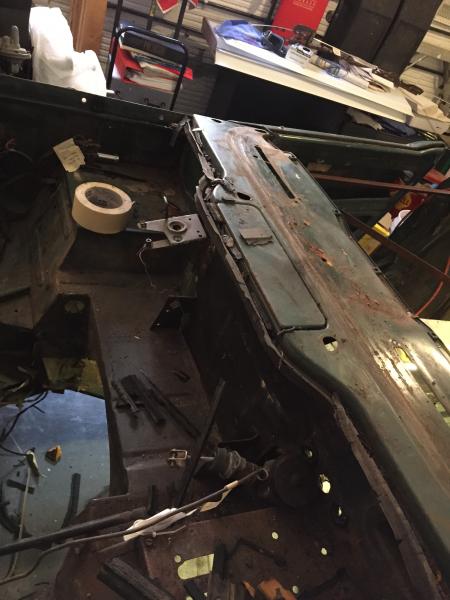

Trying to figure out the orientation of the rear bonnet seal, does the lip face forward or back? If it's facing forward it rests on the bonnet bracing and if it faces to the rear it fits snugly between the bonnet bracing and the rear edge. Piggott's book shows the lip facing forward, but that jacks up the bonnet. Thoughts?

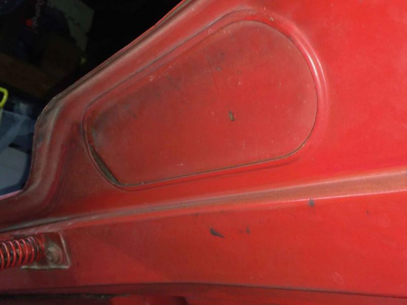

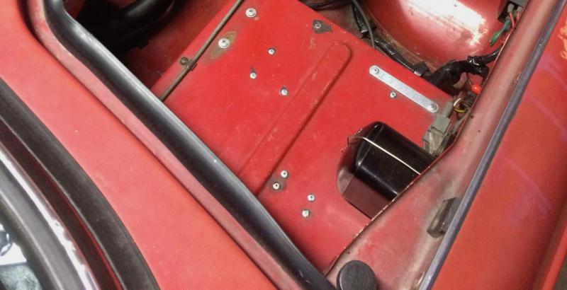

On mine, which I believe is original in this regard, the flange is on the forward side but is curved rearward. Looking for a pic...
Here:
Rut
Rut
George,
Thank you, that's exactly what I was looking for! I've turned mine around to face the rear as yours is pictured...it just makes sense when you look at the way the bonnet fits when closed.
Thanks, Rut

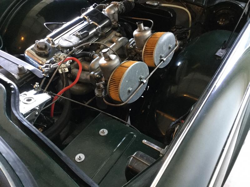

Does that seal require any kind of silicone or adhesive? I meant to be in bed by now, but I've been ogling Geo's engine compartment for several hours, overcome by that feeling of all there is still to accomplish.

But seriously, that is a gorgeous engine compartment. Hopefully we will all be there in a few years...

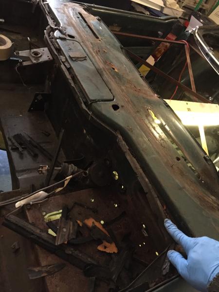

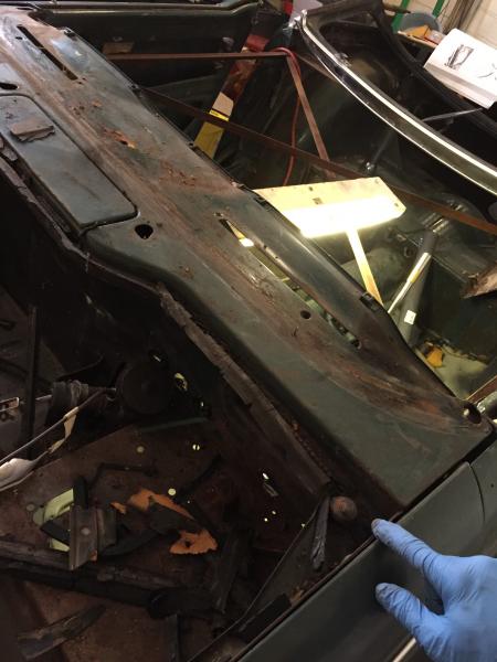

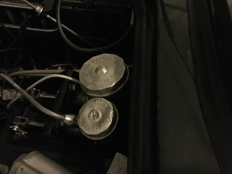

And to add to the mystery, in my car it appears to have been facing forward. Cannot say that the seal is original, but it sure was old when removed. I have not yet re-assembled, and have not had to make the decision on how to best install.
IMG_7089 - bonnet - seal at back of bonnet.jpg IMG_7090 - bonnet - seal at back of bonnet.jpg IMG_7091 - bonnet - seal at back of bonnet and bumper.jpg

Since we are discussing 66 TR4as, mine has SUs and George's has ZS carbs...was there a change in 66? My 67 has SUs as well.
Thanks, Rut
Can't give you any factory info but quite common to see both types of carbs on the 4A cars. I have cars now with SUs and ZS carbs. I do like the SUs better than the early ZS. I seem to remember seeing more SUs on the the 67 cars.

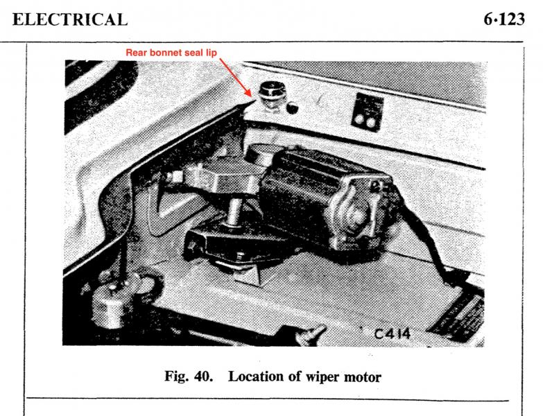

I don't know what to tell you, but the rear bonnet seal on my '63Tr4 was installed lip forward (toward engine) like in the Workshop Manual illustration and my picture.
I purchased my Tr from the first owner some 38 years ago and believe me that guy didn't replace a thing on it! He was the primordial DPO.:censored:
M.

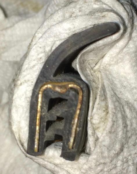

Hey Rut,
I don't understand why my seal does not contact the bonnet brace lips when it is installed with the lip forward.
Enclosed is a picture of the profile of my seal (OEM Triumph) does it look like yours?
M.

Merlin,
My bonnet seal has the same profile as yours, but if I install it with the lip facing forward it interferes with the bonnet bracing. The flat space on the rear of the bonnet is less than an inch wide in places, so there's not much room for adjustment.

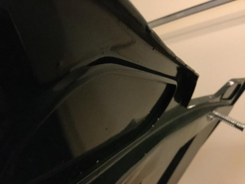

I'm enclosing pics of the seal as installed in my Tr and the bottom of the bonnet. The pic of the bonnet shows the "cleaner" area were the seal seats between the rear bonnet lip and the bonnet reinforcement gusset lip.
M.

Merlin,
When the lip of the seal is facing forward it adds additional pressure to the bonnet and the drivers side rides up. With the lip facing to the rear the bonnet is pretty even across the rear and flush with the cowl. No pictures, but I would describe the gap as typical and even with the gap along the sides of the bonnet. Please understand that while working on Desert TR I don't know what has and hasn't been done and Jims brother Steve and I just mounted the bonnet for our trip home. Although it was a quick assembly we did a pretty good job, but more adjustment on the body panels is needed before I'll be satisfied.
