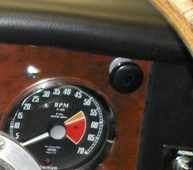

Picture of an original choke knob BJ7 anyone?
Healey_Z
Does anyone have a picture of one? The one in my car stands out on as not being original, but I'm just not sure.
This may sound odd, given that the drive line (put in 25 years ago by a PO) is not original, but this knob really bugs me because it doesn't look original to the car. Although, I didn't think the metal toggle switch looked all that original, so perhaps the choke knob was just a plain black knob and different from the others?

Healey_Z
It does have a "C" on it, but it is different shape / texture than the others. Perhaps it is an aftermarket item? I will post a picture later this weekend.

Healey_Z
Here is a crummy picture of my buggered up ignition switch and choke knob. Clearly unoriginal?
TimK
I was looking at page 167 of the Moment\Anderson restoration guide. It looks just like the one on my BN7.
H
Healey_Z
Tim K,
Are you saying the one in my picture is the same as the restoration guide and on your BN7?

TimK
Healey_Z said:
Tim K,
The photo in the guide is not a closeup but you can see that it has a "C" and not "choke". I cannot verify yours is original but it looks generally correct. Your C is bigger than the one on my BN7.
elrey
My side shift tri carb has one that looks perhaps like Z's. It has serrations like a coin around the edge and a small raised portion in the center of it's face. It also is a different shape/material than the other dash knobs.
