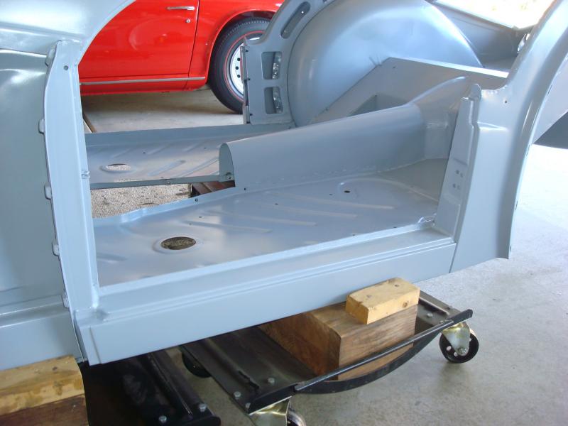

Progress continues on the 3. Going slow as I only get a few days a month to work on the car. I need some pictures of where the outer rocker meets the B pillar. The previous owner cut them out so I don't really have a reference of what they should look like after the final welding is done. So far the new floors inner and outer rockers are welded in place as well as new quarter panels toe board patch panels. I am currently working on a new rear valence and trunk floor. Doors and fenders are on the car and I am trimming and welding in 1/8 rod to get the gaps perfect. On the mechanical side I have finished the engine rebuild and now just need to figure out what I am going to do transmission wise. If anybody in the greater Philly area has a lead on an overdrive transmission please let me know. Appreciate any help and hopefully I can get some pictures up one of these days.

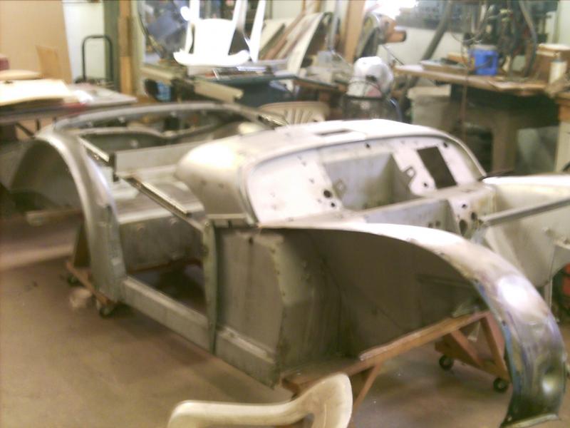

Sorry no close up shot, hope it helps.

Maybe these will help
PKPoole
Sorry for the duplicate pix. Didn't realize the first set went in. Also, I think I misread what you were looking for. It's going to be a tough morning! Someone call the home. I'm ready.

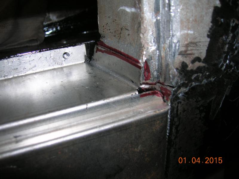

Derek,
The rocker panel should provide a straight line from the body at the B post coming forward on the bottom of the car. The face of the rocker is NOT welded in place the welds are on the top and bottom of the length of the panel plus on the 1/4 to 3/8 " tab that is vertical on the top of the rocker within the door opening and against the B post ( also in the front the same thing against the vertical portion of the A post). The rocker face seam is open but if you get it right it is a tight fit against the body panel over the B post. If you ordered a new set of rocker panels these tabs should be on there. If this is not clear I can try to provide some photos as I am currently in the process of fitting the rockers to my TR3 project.

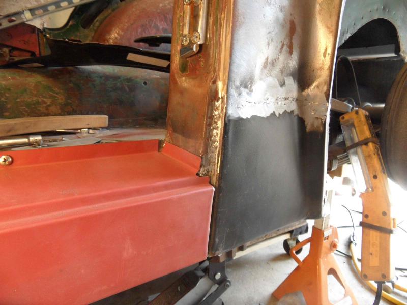

Hopefully there will be some photos of the rocker panel attached.

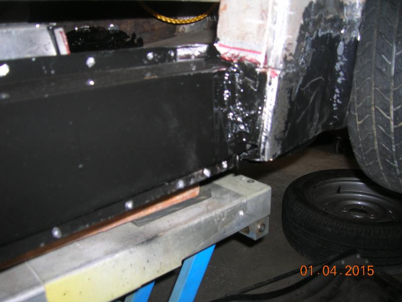

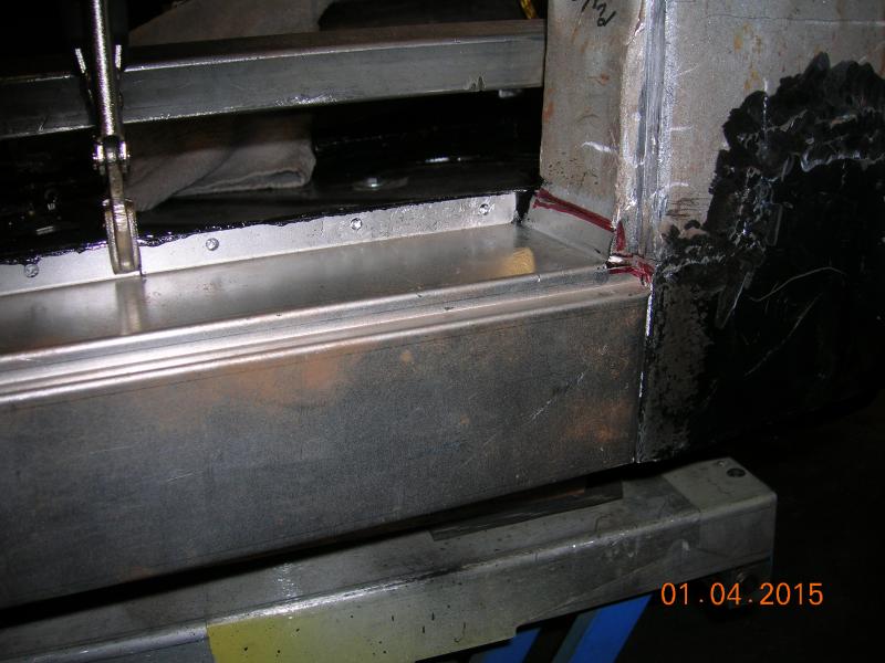

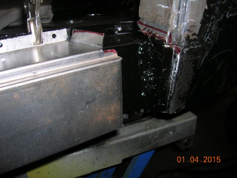

CharleyTR3 rocker panel 002.jpgTR3 rocker panel 003.jpgTR3 rocker panel 004.jpgTR3 rocker panel 005.jpgTR3 rocker panel 006.jpgTR3 rocker panel 007.jpgTR3 rocker panel 008.jpgTR3 rocker panel 009.jpgTR3 rocker panel 010.jpg
charleyf
Re: Requesting some pictures of the outer Rocker panel

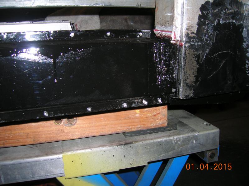

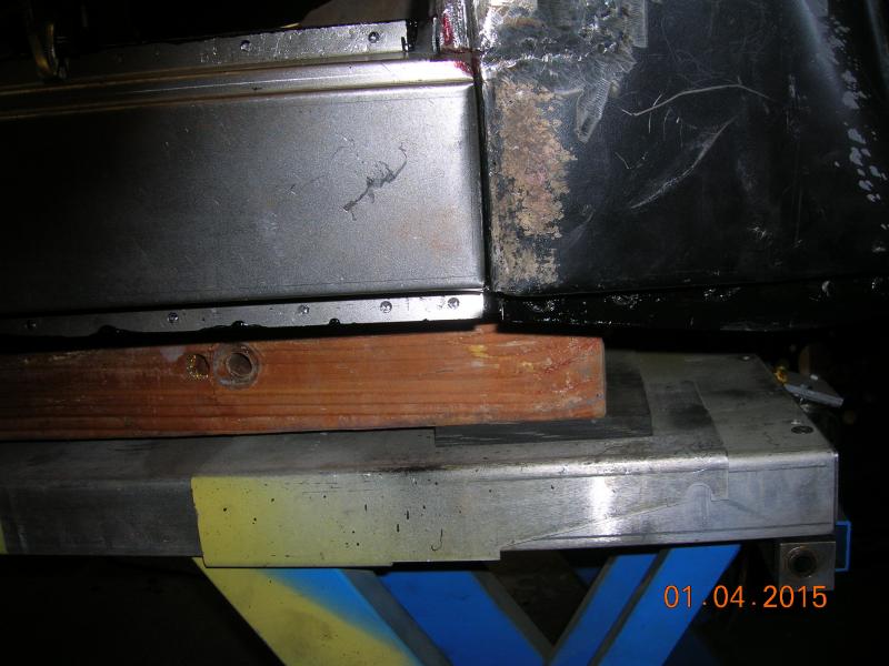

Derek,
my comments about the photos are that on this car lower portion of the B post panel was replaced. There is still some metal missing where that panel wraps around the corner into the door opening. I will use filler at the top corner of the rocker. I had to do some reshaping of the rocker to make it fit the B post panel.
Charley
T
tallguylittlecar
Thanks for the photos Charley, definitely answered my questions. Looks like the issue is my rockers so I am just going to have to reshape them a bit.

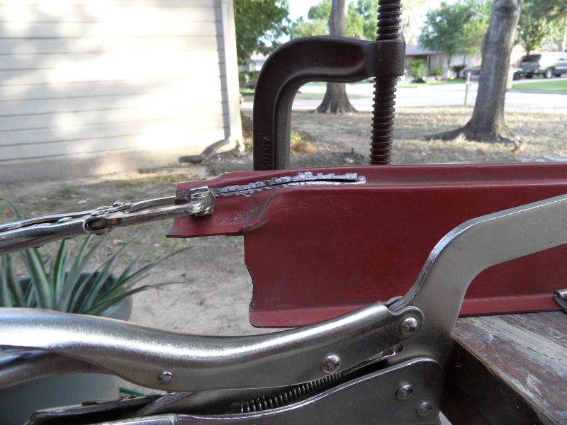

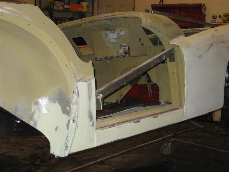

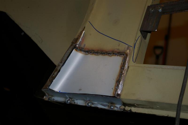

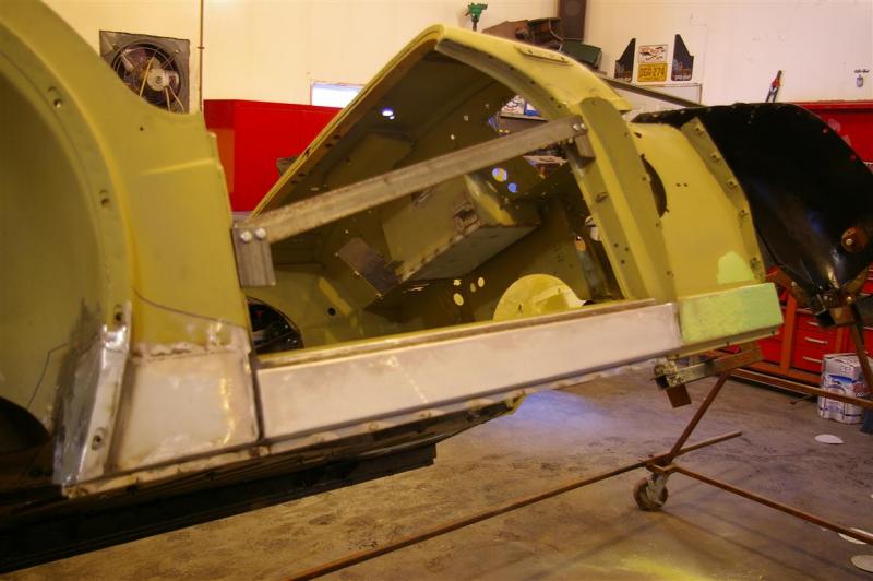

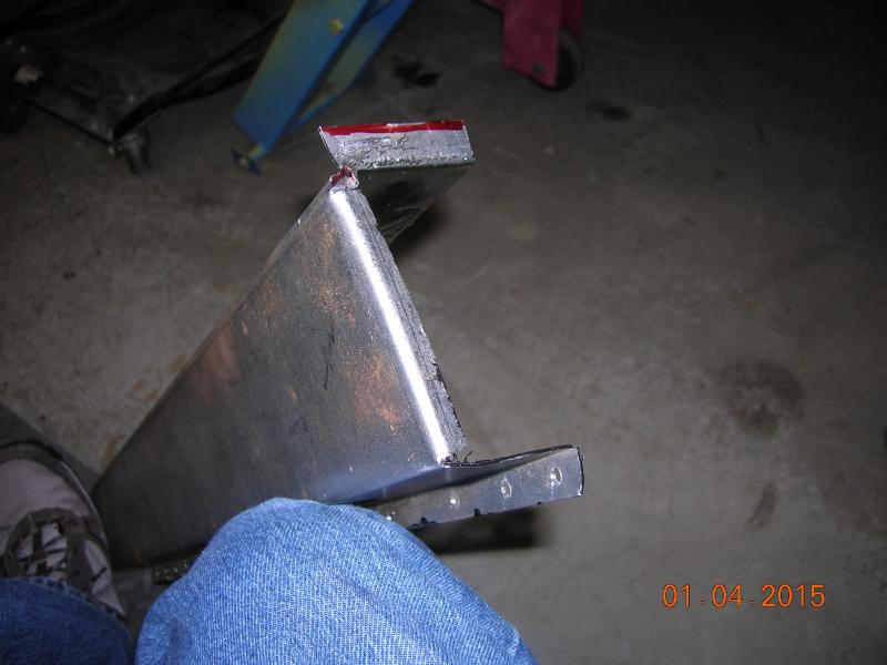

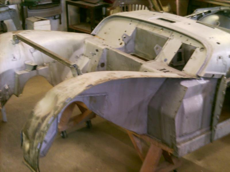

I'm only 6'1", but to fit in the TR3, I cut a little (about 3") out of the drivers seat (for a little head room with the top up).
I have a pre60k and used some new (post 60k) panels to repair rotted away sections. Since the holes were filled with wadded paper and filler, I have no idea what it looked like originally. I did have to make significant changes to the outer rockers as well as the dog legs. The pre60k outer rockers were curved (top to bottom and front to back) to match the bottom of the door. Also the trailing end was formed a little differently. I cut long pie shaped notches in the top and bottom of the forward sections of the outer rocker and seam welded it back together to get it to fit properly. I used a 4x4 and a hammer to shape a bit more. Not sure this helps, but you might get some ideas...

tallguylittlecar
Texas,
Thanks for the pictures. I have think I have what I need to press forward. Though it will have to wait until it warms up a bit. I am 6'6" and plan on lowering the seat cushions down a couple of inches.
