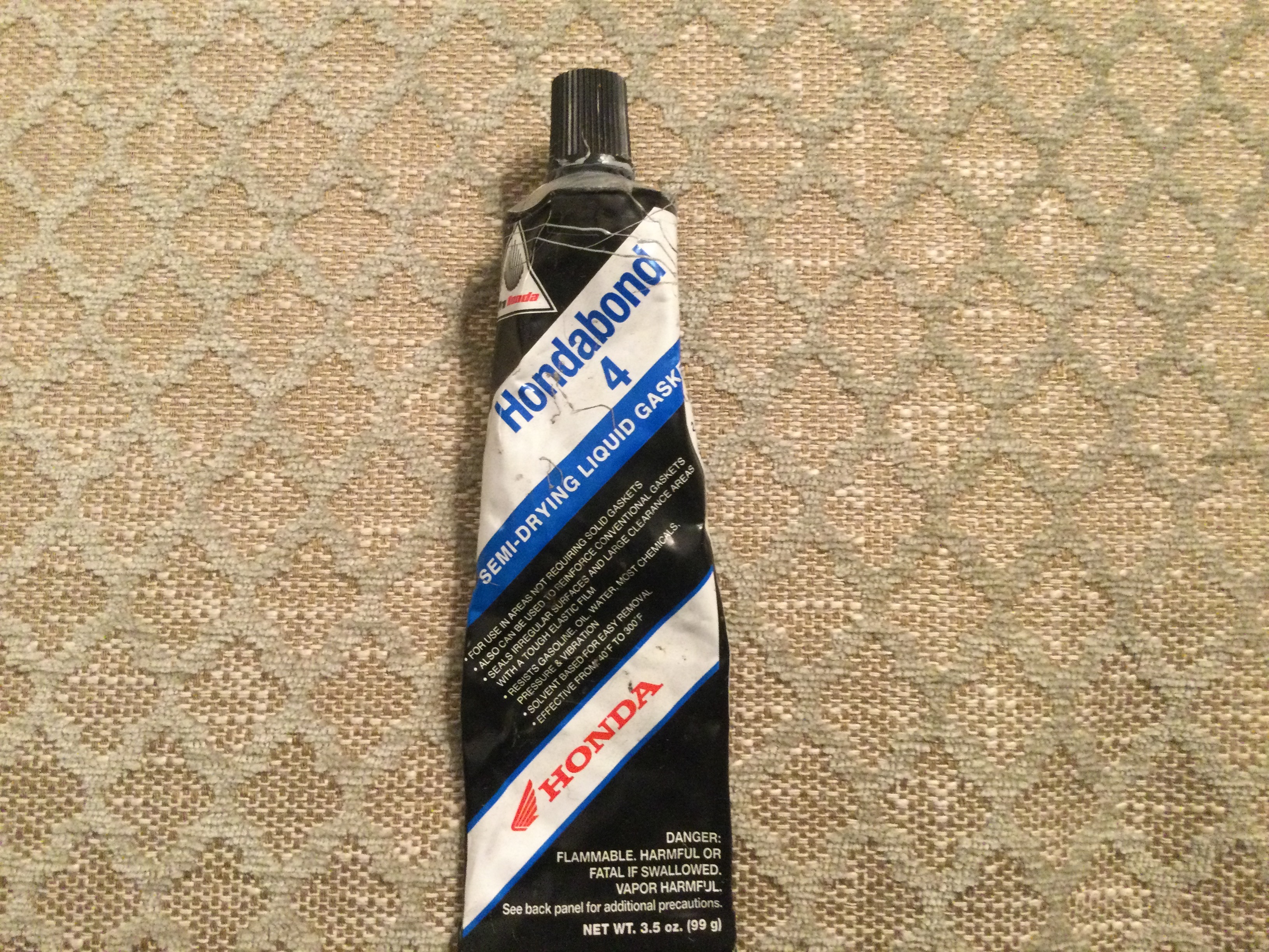

I really like Ultra Gray, but I’ve been using HondaBond a lot lately and it does a great job. I was introduced to it when rebuilding the engine on a Honda ATV. I stopped by the local dealer to purchase a gasket set and he said just use HondaBond instead of gaskets and I took that leap of faith, excellent product.

Hi Rut,
Which version of Hondabond? There is a non-setting type, and another that is more like RTV.

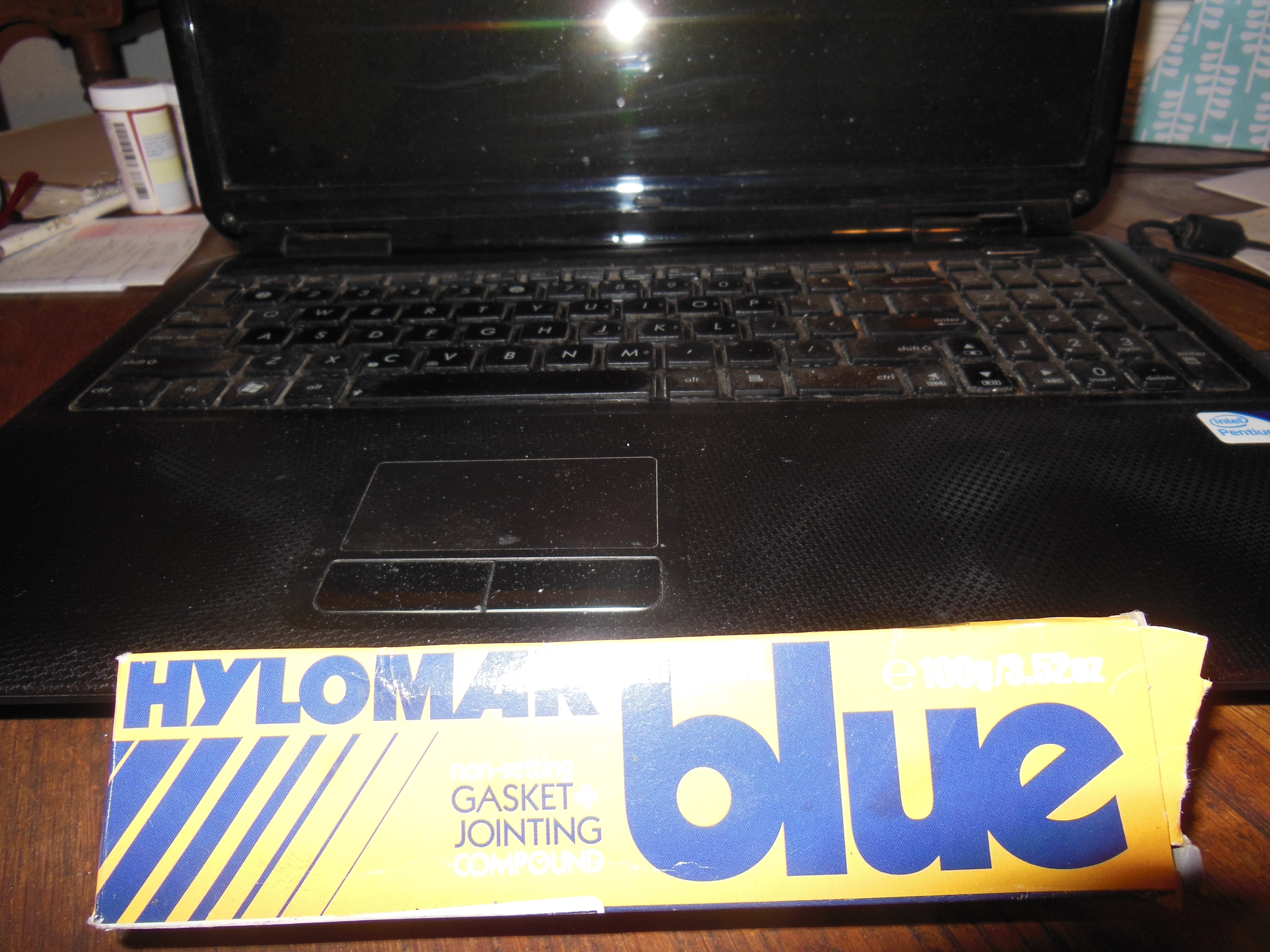

I used this Hylomar blue on my tr3 oil pan and it leaked badly. I am not sure if I used the product incorrectly or not. The leaks might be at the bolts. I used original bolts, but cleaned every surface and bolt with great care. Regretfully, I am taking the oil pan off again when I find the mood and this time I might and probably will used hardening permatex because the only engine I ever got seal tight was 327 where I used hardening permatex.
Perhaps I should have used new bolts because maybe somehow the oil is going down the bolt threads. Have any of you ever seal a pan gasket on a tr3 oil pan? If so, I am all ears on how you did it.

I did pretty well by placing the pan upside down in a piece of glass and finding and eliminating distorted areas, many created by stretched bolt holes that I peened back down using the edge of a steel table for underside support. Then I applied my gasket in two phases. Gasket to pan dried overnight on that same piece of glass and sealed with Permatex Gray. Next day to the block, Permatex Gray. Sealed very well; barely a seep.
LarryK
I used the permatex gasket sealer to pan and block, put gasket on pan and let set enough to stick the put on block, then put small amount on bolts and torqued at 25 in/lbs., then to 30 in/lbs. Warmup and rechecked.

I did similar; but used RTV on a glass table to adhere gasket to oil pan
Note, at least on the TR4A, the torque for the oil pan bolts is about 15 ft-lbs. Not much. I think the intent is to to prevent over-compressing the gasket and oil pan deformation.
