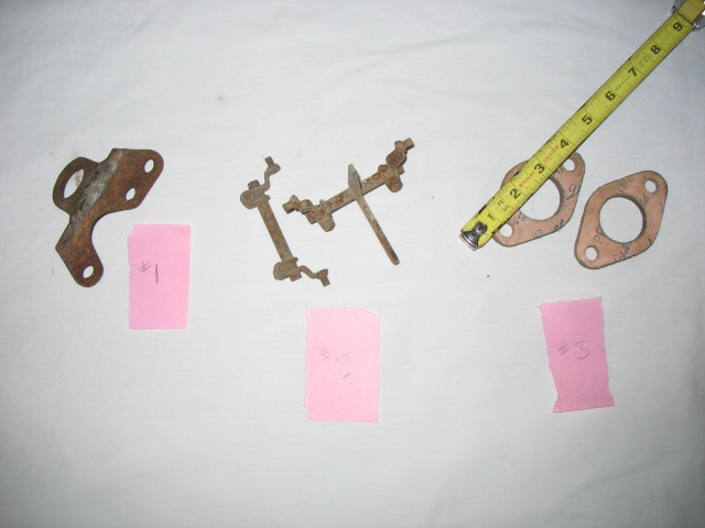

i know everyone loves to play this game, and i'd love to know what they are, so a win-win scenario. here's the pic.
EDIT: i know #3 is an insulator for carbs, but which triumph or carb?

1 is the lifting eye that goes on the head and 2 is a dual carb throttle linkage. I'm guessing 3 would go to SUs. Bring them over and we can see if they match up to my HS4's
eschneider
#1 lifting eye / bracket - spitfire.
#2 looks like carb-to-carb link for SU's. Looking at the center leverage arm, I'm guessing from an early spitfire with HS2 carbs.
#3 looks like its for an SU H2/HS2
billspit
Agree with ^^^.
The lifting eye is what I could not find for my Spitfire.
Measure the opening in the insulators, but looks like 1.25"

do you want the lifting eye? i don't have a spit and the only person i know who does i believe has his already painted and hopefully installed.
this is all from what i believe was at some time a late 60's or early 70's spit. i might also have a differential and driveshaft from an overdrive spit, how could i check this? i can find the gear ratio of the diff by spinning the input and counting the output, but what about the driveshaft?
