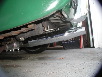

Jim_Gruber
Rut,
Go for the bullet shaped model. It takes several adapters to get to 1 3/4 as stock Spridget tailpipe is I believe 1 1/2". This one will mount easily and has a great sound. Some of the mufflers with baffles removed made Bugsy sound like a rice rocket. This provided a nice even tone that even a dedicated HArley Owner down the street gives me compliments on. This one was a freebie from local Harley ship.

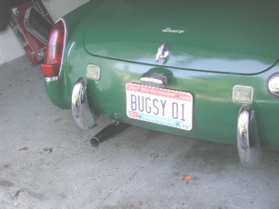

Jim_Gruber
One more shot

Jim_Gruber
If you use adapters to change size, be sure to have them tack welded together. Either do yourself or a box of donuts at local muffler shop.

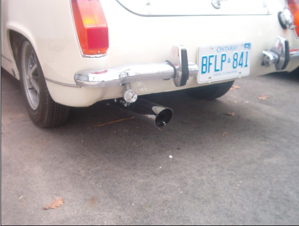

JPSmit
Mine isn't bullet shape and I love it - they had fish tail mufflers at the HD store when I got mine (I was tempted)

SM
histerical
Hey Jim. I am not a purist and " each to his own", of course, but Bugsy's bumperettes are upside down. My bugeye came that way when I got it.
