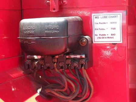

texas_bugeye
Jack
You are messing with things that should not be fooled around with; you could mess up things for the rest of us! We could all loose faith in the tried and true method of checked the oil.
