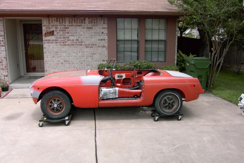

Hi All,
I am in the process of restoring my 1974 MGB. I have some parts and found 3 sets of MGB lever rear shocks in a box. Is there a way I can test to see if these are good? I didn't see any leaks. I want to clean them with mineral spirits and check them, box them up and store them in the attic until I am ready for them. Currently the whole car is stripped and I'm getting ready to begin sanding and body work to shoot new paint.
