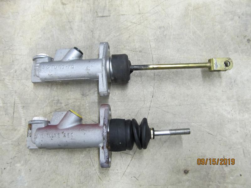

I buy new cylinders from Pegasus and they come with a threaded adjustable push rod that won't work on a Healey and the Healey push rod is not adjustable, so the shims are the only way I know to adjust pedals.

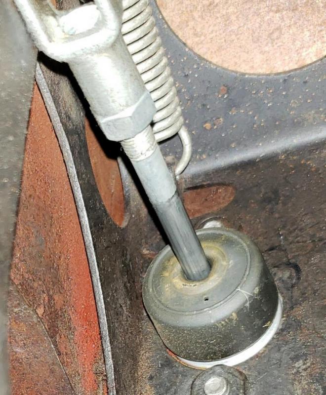

On the push rod, I guess I should have qualified - if you want to use the threaded push rods that come with the Girlings from Pegasus you would have to add clevis ends & make sure the length is right. IMO, easier and better to just use the non-adjustable Healey ones.
Top is Healey, bottom is as received from Pegasus
Dave

Was questioning the idea that adjustable pushrod setup won't work in the Healey.

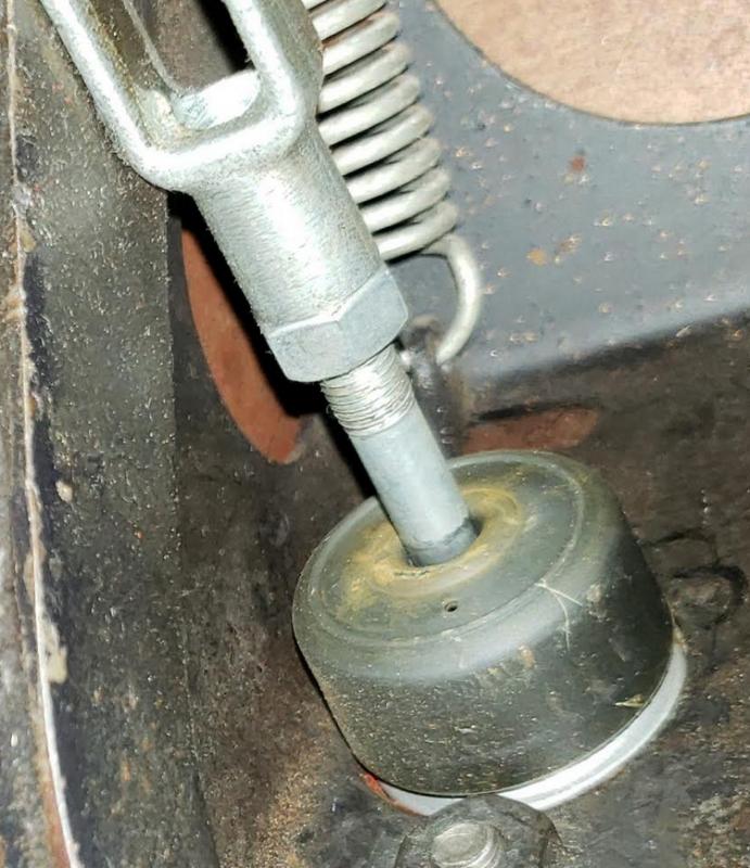

Bought my car in '99 and it had one of the cylinders with adjustable clevis; I added another Pegasus and bought a clevis from a local hardware store. Not knowing better, I adjusted both so there is a little play before the piston is engaged. Never had any problems.
According to Pegasus, the Girling M/C stroke is 1-3/8". I checked my clutch - and the stroke until the pedal hits the floor is 1-1/8".

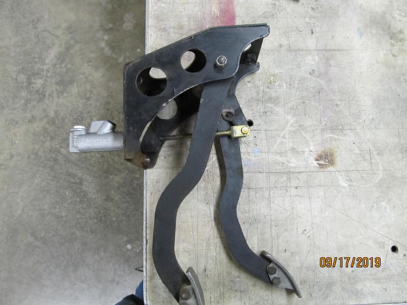

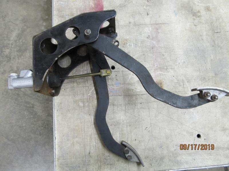

So, I'm gonna try again, because I don't think what I've been saying is being heard and some of what I've read doesn't make sense to me. I am currently restoring a BT7 and just a month ago installed the pedal box and masters (new masters and new pushrods and new clevis pins) - when I installed both without shims, the clutch pedal was 3/16" high compared to the brake so I put shims under the clutch master and the pedals are now even. This is why it's fresh in my mind so I took some pictures to help explain what I mean.
First, Steveg said in post #11
Not knowing better, I adjusted both so there is a little play before the piston is engaged." I think you may be remembering another car or your pedal box has been modified because
there is no stop in the pedal box or pedals, they can swing as far up as you might want (they do sort of run into the return springs when lifted real high but it's not any kind of positive stop). The only stop for upwards movement is the washer and snap ring in the master that keeps the pushrod and piston inside the master. So, the pedal return spring pulls against the snap ring and washer (stop) and the only 'play' is between the stop washer/snap ring and the piston in the bore. So there is nothing to adjust to - if you have a threaded pushrod and keep turning, you will just keep raising the pedal height (or lowering it depending on which way you are turning it). Here is a picture a spare pedal box out of the car with a brake master in place and hooked to the pedal - you can see the clutch pedal is free to swing waaaay up from where you would want it - there is no stop on either pedal. (I have 4 of these pedal boxes and they are all the same)

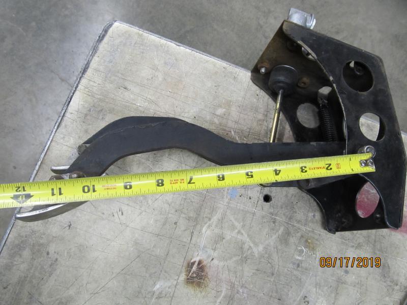

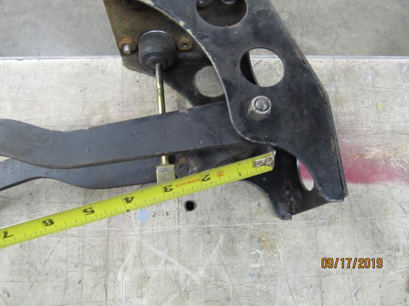

Second, Vette said in post #19
It seems to me that there is enough play in at least the clutch pedal that it would take a lot of shims to effect the height of the pedal."
Again, the shim is 1/16" and the distance from the fulcrum to the clevis is approximately 2 3/8" for the clutch and 3" for the brake and the distance from the fulcrum to the center of the pedal pad is 11". So a disclaimer: I am not good at math, but this clearly is more than 3:1 ratio, thus .062 x 3 = .187 (3/16") or more so a 1/16" shim would mean at least a 3/16" or more pedal height change. Someone with better math skills would be able to say exactly what the clutch is vs brake... but that's not me.
So, obviously I haven't read any factory literature about them so can't cite a source but just because Moss shows something doesn't always mean they are right either :smile:.
