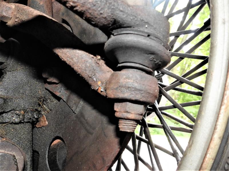

Both front wheels are tight. There's a tiny bit of play in the left front - barely measurable. The rubber parts are a bit tired looking. See pictures. I took it out after adjusting and the pull was barely noticeable. Evidently the rear brake adjustment helped a bit. I pumped the brakes hard hoping to free up the piston if it was stuck. The car doesn't get driven much and that may be a problem. Sway bar link2.jpgTie rod end.jpg
How do they look to you experts?

Really hard to tell externally. But, big pair of Channelocks, squeeze the tie rod end together.End of the stud one end, top in the middle or net to the grease fitting. Just to make sure.Control arm bushings, look at them.My wife's car after new tires got real squirrely at speeds over 70, lower ball joints 1/4" of play, tops loose.
