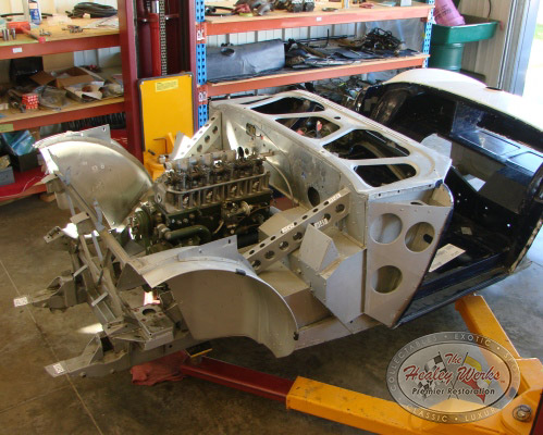

I am slowly trying to work my way through all of the noise, harshness and vibration that resonate from the various body parts of my 1954 BN1. It was fully mechanically restored in 2010 (newly rebuilt engine, brake system, wiring harness, fuel lines, etc.) and runs like a dream. But the body hasn't been touched since I painted it (poorly in shop class) in 1984. In other words, it looks like a butt-ugly "rat rod" and the gremlins I am now chasing all have to do with the body structure.
I fixed the loudest and most annoying rattle by finding a new rubber grommet for the hole in the firewall that the hood release lever was vibrating against. Yippee!
The next most obvious/loudest vibration is coming from the front left fender (wing). When I lean against the fender with the car idling that particular bit of noise and vibration stop. I have seen pictures of cars undergoing restoration that show two rubber bumpers (for lack of a better word) that appear to wrap around the outside edge of the inner fender. (A copy of one showing the bumpers is attached). From the pictures I have seen they seem to be riveted in place Those seem to be missing from my car on both sides and I suspect that is causing my problem. Any idea where I could buy replacements? I can't find them online or in the Moss catalog. Failing replacements for sale, any suggestions on a home-brew remedy?

Or you could try SC Parts in Germany or France if you want somewhere a bit nearer - part numbers 19558, 282489 and 204791 - rubber - washer and rivet. These are for a BN4 to BJ8, there does not appear to be anything listed for a BN1 or 2, but I guess that if it stops the rattle, you would not mind if it was not original?
:cheers:
Bob
vette
Yep Greg's got it. rubber bumper wheel arch. Or you can use a split piece of fuel line hose.
