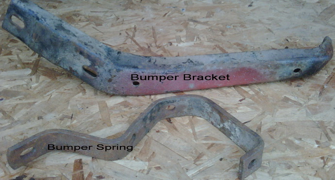

Russ Austin
Emmett; Are you talking about the brackets springs that attach to the bumper or bumper brackets that attach to the frame? The bumper springs are available the bumper brackets are not.
Russ Austin
Just caught that's the rear spring not the front! Duh!
